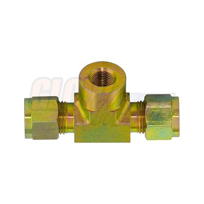

Posts: 7390
Mountainman wrote:
Ah thanks, that makes sense. I don't have AC, but I have big mountains to drive up. I wonder if my 3/8 NPT bung on my pan will easily fit an available sensor, Google time...
But, then again, I like the idea of getting the hot line out temp even better since Thermorex is maxing out at 170 in the pan. I probably better put a bigger cooler in and a deeper pan since my temp light came on twice after the bigger tires :shock:
They sale a block to mount inline (3/8) for the temperature sensor like the one I installed on mine. (first picture)
Glowshift also sales a inline "T" block fitting for sensor.(second picture)

I installed a deep aluminum pan that has a port for a sender, I've never seen over 160F since on the hotest days going up hill with TC unlocked. Automatic transmissions create so much wash through the pan via the return lines and filter pickup that temps from the pan or the output port are really close. It isn't a stagnate lake in the pan. I used the tee from glow shift before I changed the pan, didn't notice any discernible difference.
