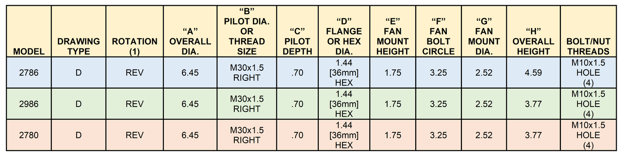

The 2986 is still listed on a few web sites, not sure what the story is on that part number. Would have to call Hayden to find out?
Amazon still lists them as available:> https://www.amazon.com/Hayden-Automotiv ... B000EQ7A9O
The 2986 is quite a bit more expensive than the 2786 at almost twice the cost. Not sure why so much for the 2986.
The problem that concerns me about the 2786 is it's overall height. All other specification numbers are identical.
The 2786 is 4.59" OH
The 2986 is 3.77" OH
This may present a clearance problem putting the taller fan clutch so close to the radiator stack?
They do list a 2780 and it has the exact same numbers as the 2986, OH are the same. 3.77
See this web page for a listing of all Hayden part numbers and their specifications:> http://pageturnpro2.com.s3-website-us-e ... -20-10.pdf
Yeah, calling them to confirm would probably be a good idea. I seem to recall that when I did that (18 months or so ago), the person I spoke with wasn't really able to tell me what the differences between the 2986 and 2786 were, just that the 2786 replaced the 2986. It sounds like there may be some fairly significant ones, at least as far as installation in a CRD is concerned.
