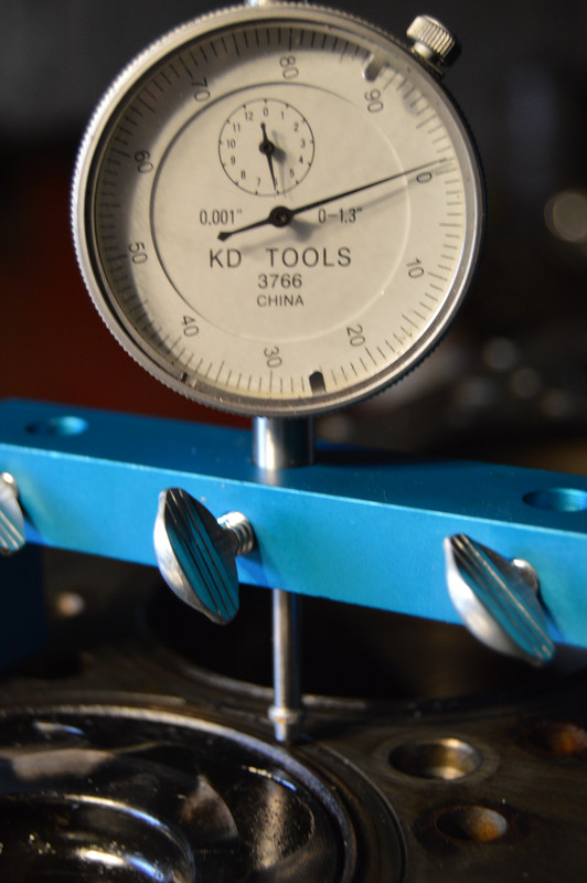

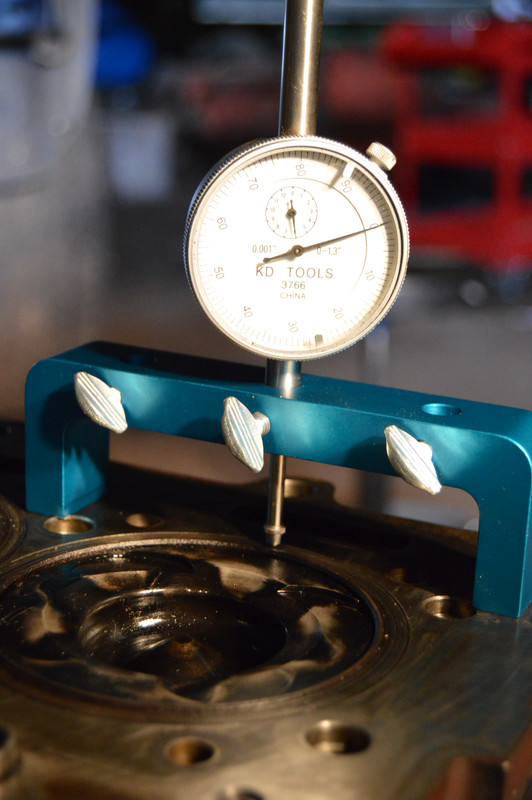

Look at the liners along the exhaust side of your block. Now look at how this compares to how they 'appear' to be on the intake side. I'm talking about how high they set in the block. It really stands out on the rear cylinder.
I'll be the first to say that pictures can be deceiving; angles, shadows, lighting can all be misleading.
But just looking at them sure seems to me the exhaust side seems lower than the intake side.
Only way to really know is if you measure them. They must be at least level (zero protrusion) up to .0019 inch 'above' the deck. VmSpecialist recently told me to even push this to .0025 inch.
My engine had the exact same thing. 2 of my liners were 'sunk' below the minimum height, along the exhaust side. Not much, but definitely lower than the block. .001 inch below.
Here's a pic of mine showing .001 below deck surface
This is of a level, or 'zero' measurement
Measuring liner protrusion is a VERY important thing to do whenever the head is off. The only time any 'measuring' is mentioned in the service manual, is when fitting new liners. Which of course is important. Just as important is to check them whenever the head is off.
Liners can 'settle', or work-in over time..The lands where the shim spacer(which is soft brass) can and do erode... and lose their set height. This raised portion (designated under 'A' in illustration, but this pic is without a shim... so it's actually below deck height here) is the first and main source of sealing the cylinder, sealing combustion from escaping out under the HG, or down past the liner itself and directly into the coolant. I've worked on just about every brand of wet liner type diesels, and not one is immune from this occurrence.
^^^^ This is a poor picture from the fsm.. it's confusing because of the 'shape' of the liner they show. The shaded part of the liner seems to continue on where a fast moving piston would not appreciate it.. :roll:
anyway, the proper shim placed on the ledge would set the height @ 'A' to a minimum of zero, to a suggested height of (let's just call it .002 inch)
All my diesels, no matter the displacement, or brand, all seem to share a .002 inch spec in this area.. and as long as they are STILL above deck height, there is no problem. The head gets re installed.
So, I'd sure recommend that this check is performed to confirm your liners are within spec. Now's the time to fix it if it's warranted!!!
Measure around each cylinder at 4 places.. Vm said not to worry too much about 'uneveness'.. say one side being .001 different than it's opposite... as long as the LOWEST PART is no less than 'zero' @ deck surface.

4. the ONLY thing that can change the amount of 'bite' or seal in this particular instance, is how much the liner protrudes up out of the block... and INTO the flat gasket surface. Thick or thin gasket, it is flat, and if the liner sticks up .002, then it's going to bite into the gasket exactly .002 inch. regardless of how many holes it has
Please explain how a taller gasket makes a better seal in this case.
If these gaskets were 'soft fuzzy' gaskets, that needed to have a lot of flexibility to fill deep gouges, pits, etc.... then YES. Thicker would be better...
