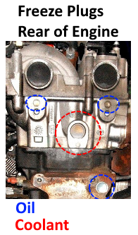

Make sure there are no leaks on the coolant hoses connected to the coolant tank that is bolted to the firewall.
The oil cooler is also on the passenger side of the engine block.
There is a freeze plug on the back of the head as pictured below.
A cracked head or leaking head gasket is also possible but highly unlikely. :shock:
A pressure test with UV dye and a UV light will be your best bet to pinpoint leak.
Rear of engine:

wwdiesel,
thank you for the picture. It has really helped out a lot.
from the picture am I correct that the lower freeze plug actually has
Engine oil behind it ??
I was able to get a light an mirror situated so I could see the freeze plug in the rear of the
head. looks good no issues. In another picture I have from a facebook poster I see the other
freeze plug. So if that in fact does have oil behind it and not coolant Our only other possibility is the
block is cracked. its ok to tell me I'm wrong. I have a " selfie " stick coming tomorrow so I can get my phone up in
there to take some pictures. for a look at what's really going on. I was really hoping it was coolant behind plug number two.
I fear the worst on this one.

The lower freeze plug circled in blue is the end of a common oil gallery in the block. There are threaded access ports to this, back to front, on the exhaust side of the engine, as well as internal supply channels to critical systems.

kibbleking wrote:
wwdiesel,
Yes, the blue circled items are oil plugs, not coolant.
again, A pressure test with UV dye and a UV light will be your best bet to pinpoint leak. :wink:
