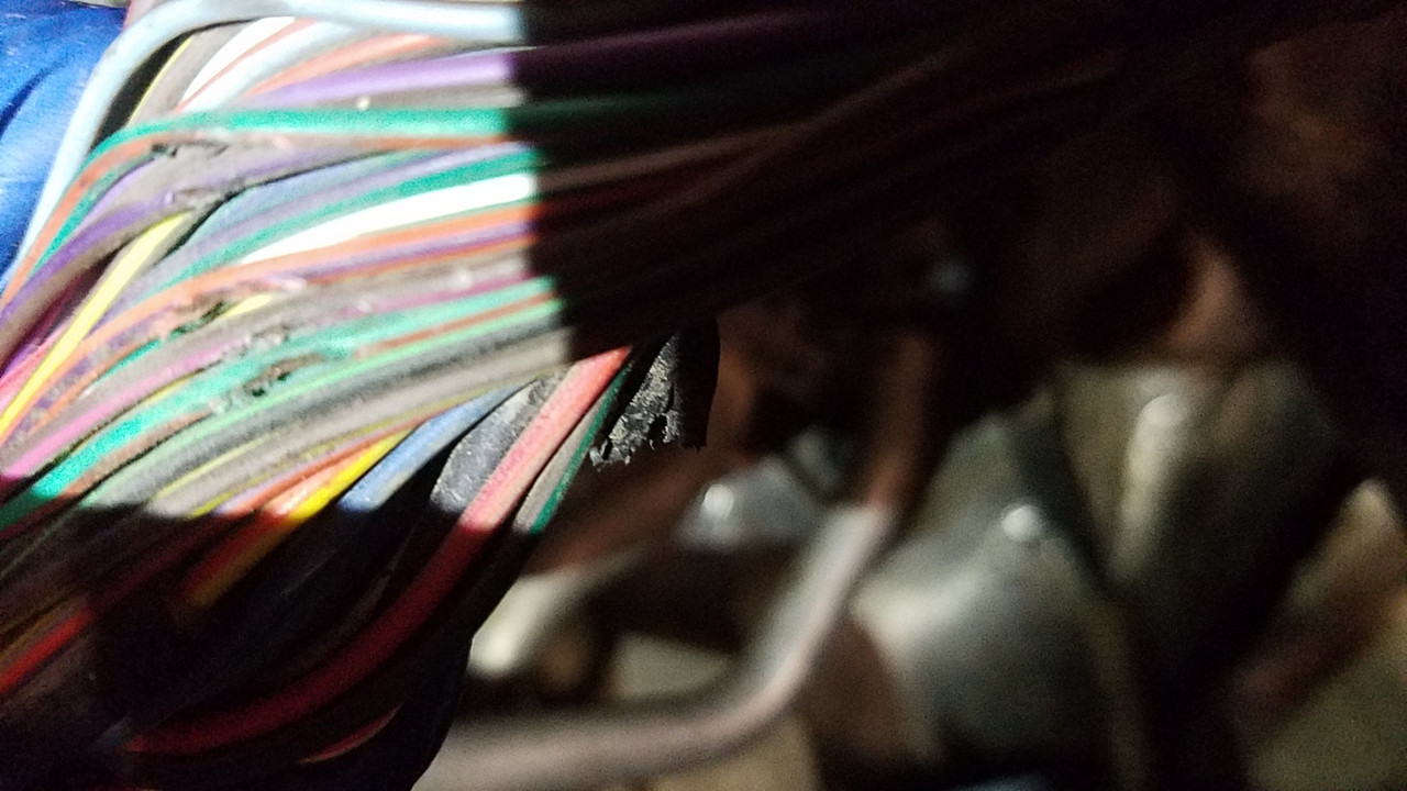

Wow, bummer. I spent 6 months tracking a ghost hard shift limp mode issue in my rig. Here is what I found in the TCM harness near the. A/C accumulator. It would present randomly. Best you check that harness so you don't :5SHOTS: after the swap.

Thanks vw... I'll check those wires again. Seems like I rubbed 400 miles of wire looking for faults already. But a good reminder sometimes you see but don't see.
