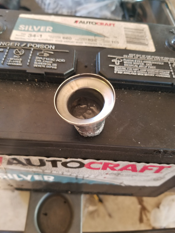

I completely removed the egr system. I would up cutting the end off the exhaust tube where it attaches to the elbow. I crimped the cut end and filled with an inch of JB Weld. I would attach a picture but I can figure out how.
I hope the JB Weld will hold up to the high temperatures of the exhaust manifold?

I was able to use the plug provided by sasquach for the exhaust manifold. The JB Weld was for the intake elbow.

All said and done it should work. I removed the egr and kept the original elbow and butterfly valve. It will require a tune for the cel.
