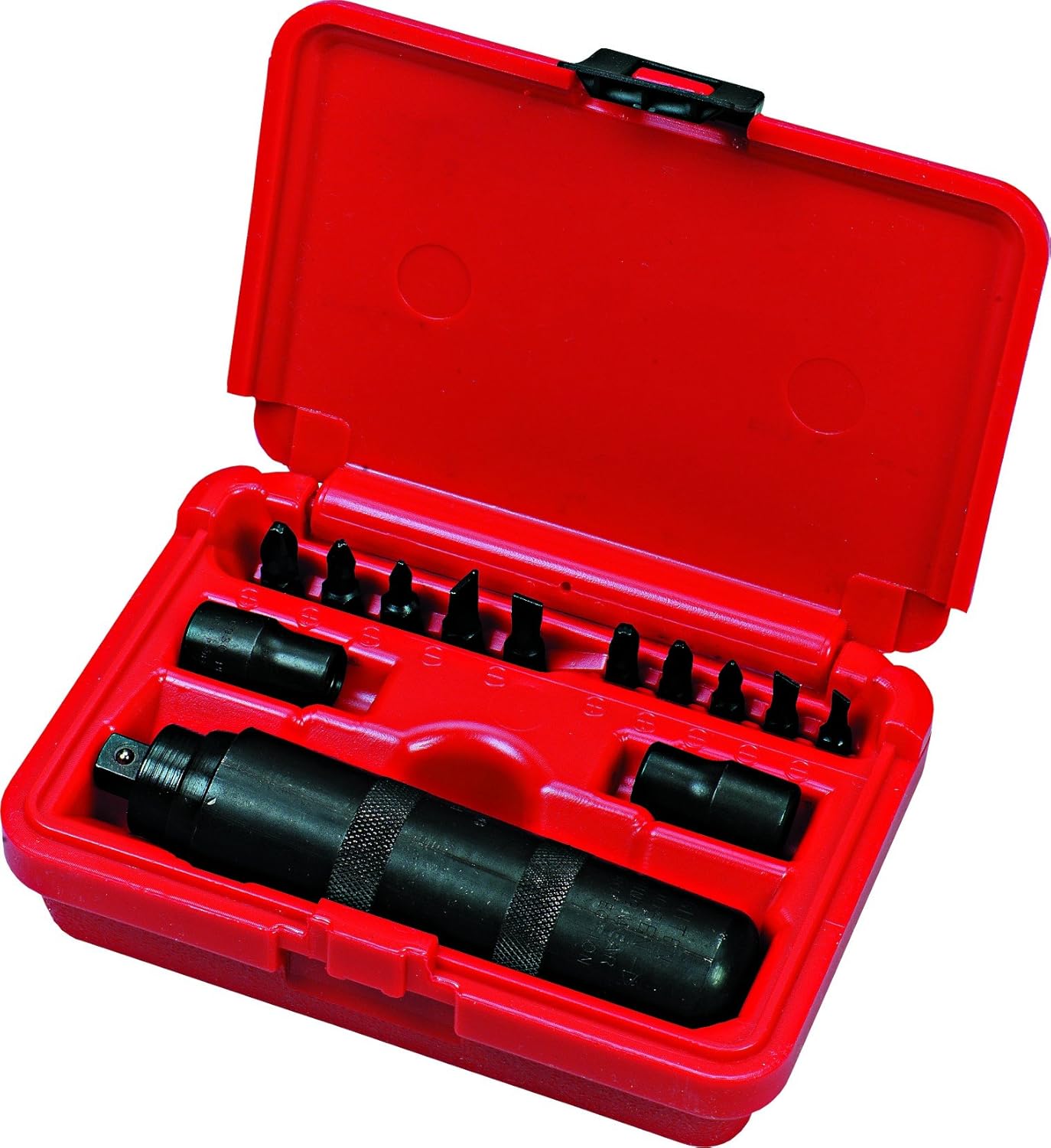

If the screws give you problems, I found that using the type of impact wrench that works with a hammer worked the best to loosen them up.
https://images-na.ssl-images-amazon.com/images/I/81gBEFi5L5L._SL1500_.jpg or comparable.
Yes, I have one of those. They work really well. I didn't have a problem with the bolts though, just the differential end of the drive shaft is stubborn.
