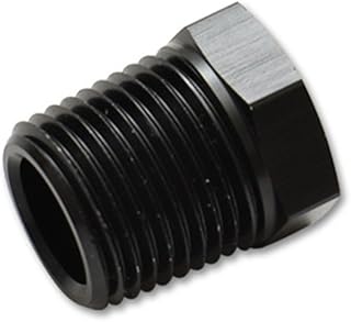

What I did early on when I bought my Jeep and discovered someone had already put an oversized self tapping oil drain plug in the oil pan and it to was stripped and would not tighten up.
A simple fix using readily available parts from any hardware store.
It is still working just fine with no leaks and nothing hanging way down to get caught on something.
Tap stipped drain hole in oil pan with a 1/2" NPT tap (tapered threads). Only tap using about 1/2 of the tap since it is tapered.
Insert a 1/2" x 3/8" steel or brass pipe bushing with threads liberally coated with red high strength LocTite or other high strength thread locking / sealing compound.
Then screw a male 3/8 hex plug into the pipe bushing with teflon tape on threads.
Then when you change oil you only have to R&R the 3/8 hex plug out and back in the pipe bushing. The 1/2" pipe bushing basically becomes a permanent part of the oil pan.
Problem solved.
