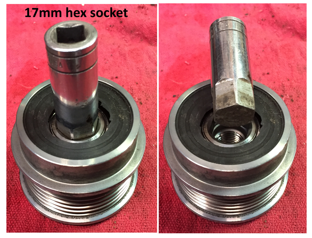

Way back when I first had mine changed; I took it to a local starter/generator repair shop and he stuck an air impact wrench on it and bumped it once with the air impact and it came right off.
He used no special tools and told me some Toyotas also had this same override clutch on their alternators and he was well versed in changing them.
He screwed the new Litens Alternator Pulley on by hand and bumped it one time with the air impact and handed me the alternator.
He did not even charge me any labor for changing it out.
So, when my alternator died about a year later, I used the same procedure in my shop using a air impact to remove the fairly new Litens Pulley before turning the core into Autozone when I purchased a new alternator that came with a new pulley.
Saved the Litens Pulley for a spare in case I ever need it. :D

Could you give us a bit more detail on this removal procedure please!
Do you drive the female Hex section in the clockwise direction when looking at it from the front or counter-clockwise?
Or do you simply drive the square 10mm female slot with an air impact and if so in which direction?

Finely found my used pulley.
Using a 17mm hex socket, hit it with a strong air impact wrench in a counter clockwise direction a couple of times and it should spin right off the alternators shaft.
Install is reverse of removal.
You will need a 17mm hex socket as pictured to perform this.

Thanks for this picture and description WWDiesel!
Makes sense now :wink:
