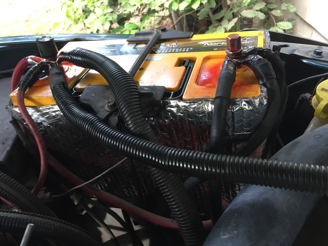

Glad you got it sorted out and it was not something major or expensive.
I hate clamp on battery terminals! And those side things that GM invented are a total Joke!
Whenever possible, I use a battery with studs and convert all cables to ring terminals. They hold tight and never become loose for any reason.
They also do not set up corrosion and resistance between connection surfaces.
Unfortunately, I was not able to do this on the Jeep diesel, but was able to on my Dodge diesel.
I put homemade rubber covers over both the positive + nuts is to ensure nothing ever come in contact with the terminal (5000 X 2 short circuit amps)
