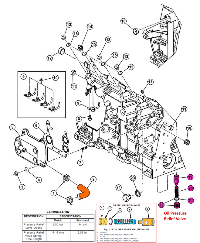

This engine has a "Oil Pressure Relief Valve". This valve should dump oil pressure at a present pressure to prevent over-pressure.
The oil filter and oil cooler can only handle so much pressure.

good point ww about over pressure and relief valve . but in my case my engine is in excellent condition , when cold in winter time , mechanical gauge pegs over 100 psi so seems relief valve is set higher ,after few mins it drops down to 80 ish. itd be nice to know the exact limit.

according to tdi guys on 1.9 tdi VW engine maximum oil pressure is 7.0bar=103psi so im guessing vm 2.8 is the same.

It says right in the schematic that the oil pressure relief valve opens at 94psi.
