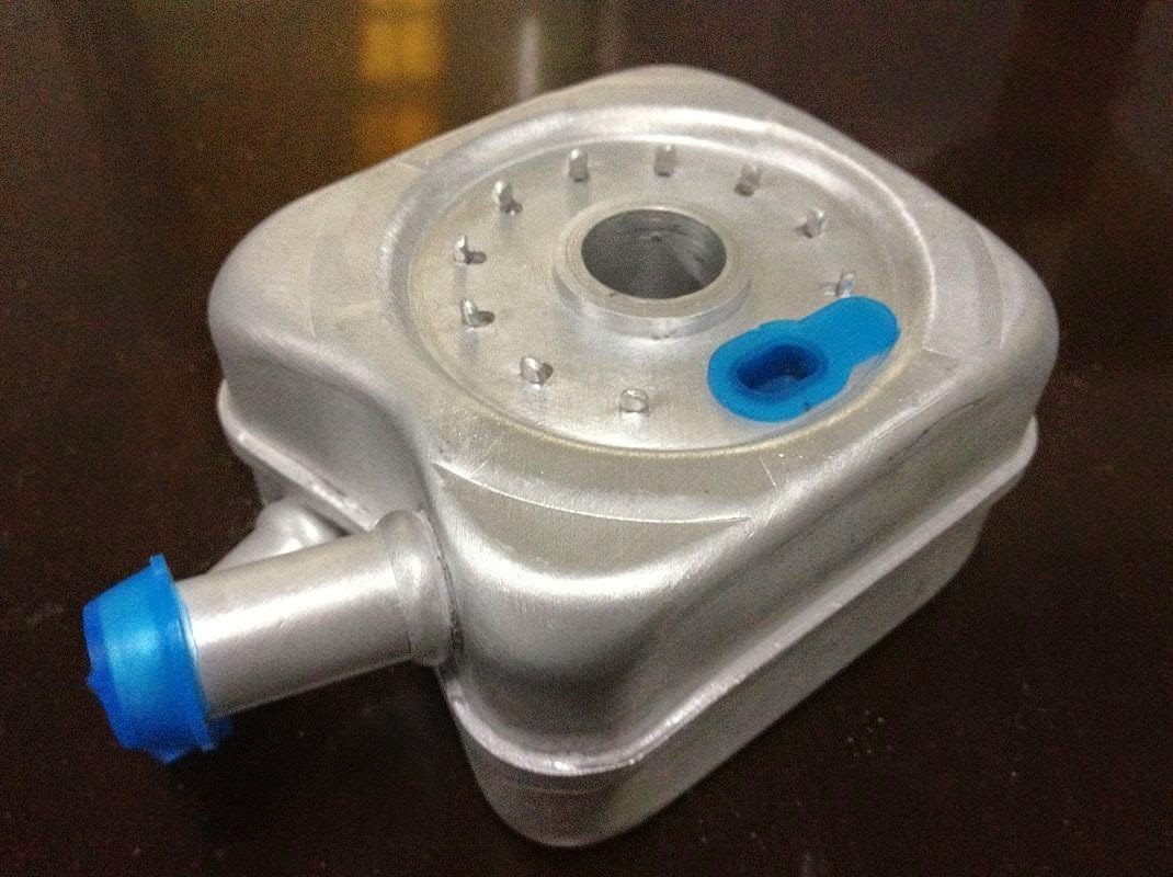

It's not just that the oil cooler is missing, in that sketch he's showing, the block is designed to use the German-Style "pancake" oil cooler that threads on between the block and the oil filter. (Side of the block, Below the pump)
IIRC old Audi 5cyl turbodiesels (100? 200? 5000?), and (I think) early Jetta 1.6L turbodiesels used that type, along with a funky 3-way molded rubber coolant hose.
It's a different burro altogether, and would need an extra water pump inlet of some sort.

Either is possible I suppose, but the sketch definitely shows a spin-on type casting where the oil cooler should be, and it lit up some long-disused and abandoned memory synapses. I've only seen that type on German vehicles, but they could be used on older Italian types as well. I've not seen them used on anything OEM since late 70's or very early 80's and they were troublesome for oil seepage, as I remember.
Volkswagen clone type / mount
Image Image
"Afterthought" oil coolers
One of VW's very WORST ideas.

Our oil cooler coolant flow enters from a port in the block, the coolant flow exits the cooler and goes straight into the large suction pipe on the back of the water pump. The non-used port JeepLovR is referencing is on the discharge side of the water pump and would be needed for a sandwich type oil cooler as described.
Thank goodness we do not have such an animal on our Jeeps... :BANANA:

WWDiesel wrote:
Gordo, that looks like a nightmare just waiting to happen! Leaks that is. :grim:
Yeah, I was never a fan of this sandwiched cooler system. With all the known OEM weaknesses we address at it is, I"m glad we don't have that as well.
Short of a dry-sump / air-stack oil cooler system, I'll stick with what it has.
