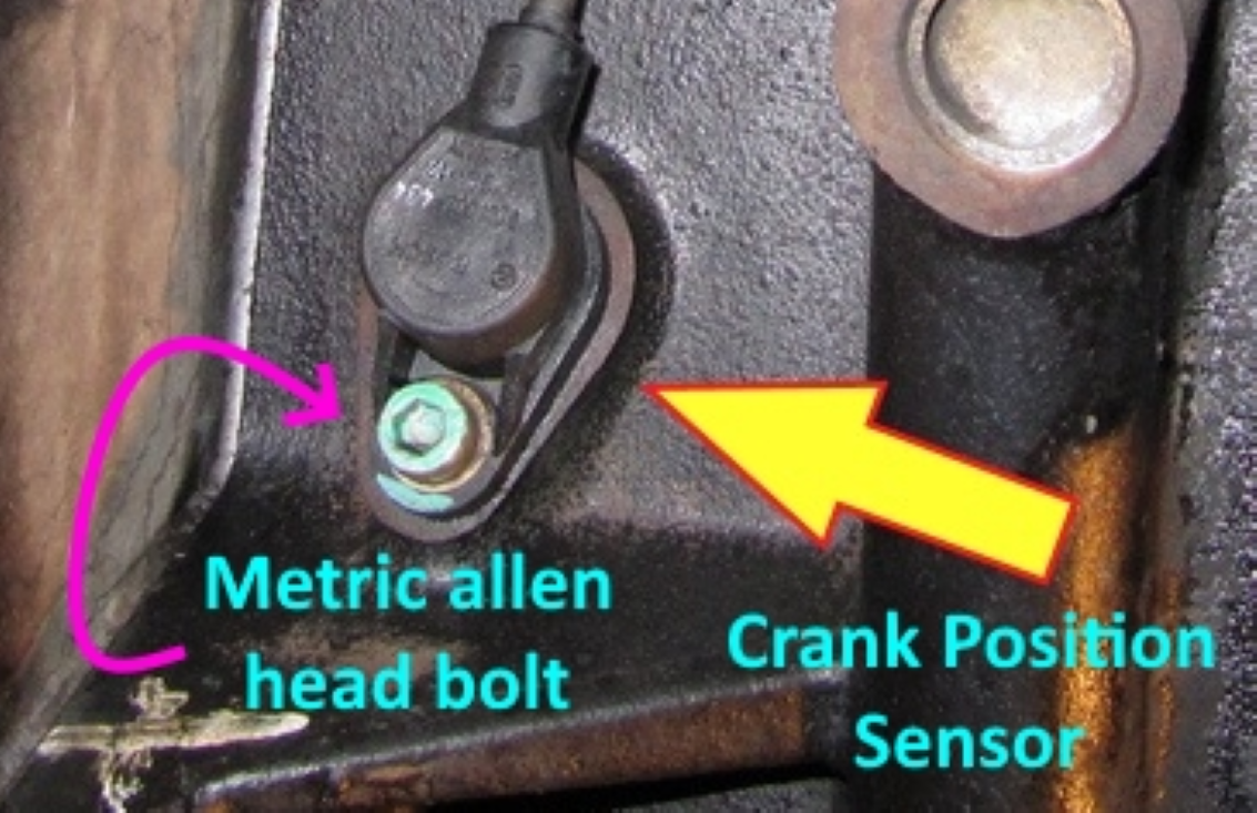

Think I'm giving up on replacing the crankshaft position sensor for now.
Thought I would share here that the bolt that holds that on appears to be, of all things, a T30 Torx cap screw. That would have been extremely useful for me to know, as you cannot see it from underneath and I munged it all up with a 5mm allen key before I came at it from the top (removing the coolant tank) and realized what it was, or at least used to be. No way to get hold of it now and it is thoroughly seized in there.
Is this unusual? I'm surprised no one mentioned this odd fastener, and the replacement part listed on IDparts looks like a regular 10mm bolt.
The reason no one mentioned it; normally it is a 6mm metric "Allen Head" bolt as pictured below!
Someone must have replaced it with a Torx head bolt? :shock: :shock:
You can see clearly in this picture the head of the bolt holding the CPS.
[/url]Image

Well, its hard to see, it may just be that I beat it up so bad it looks like torx. But are you sure it is supposed to be 6mm, not 5mm? Still cant get a 6 in there.

if its original it is an allen screw I thought it was a 7mm but it could well be a 6mm I used allen bits that fit on ratchet to get mine out . You might try some pn blaster etc. and a pair of small vice grips if you can get that on it or even needle nose vise grips. If you move the exhaust downpipe out of the way you should be able to get to it.

A trick for removing a beat up Allen head bolt actually employs a torx socket. Tap a torx socket that is slightly larger than the rounded out Allen hole firmly into the bolt head with a hammer. This can get you just enough purchase to loosen the bolt with a ratchet. You'll want to replace the bolt with a new one upon reinstalling the sensor. Good luck!
I was referring to the bolt itself, it is a 6 x 1.0 mm bolt, the wrench to remove it may well indeed be a 5mm allen wrench?

I checked the size on the salvage jeep I have been working on either a 3/16th inch or a 5mm allen wrench fit mine but I am sure its meant to be metric so 5mm allen wrench and its same size that fits the intake pin holes caps
