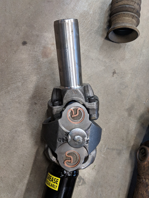

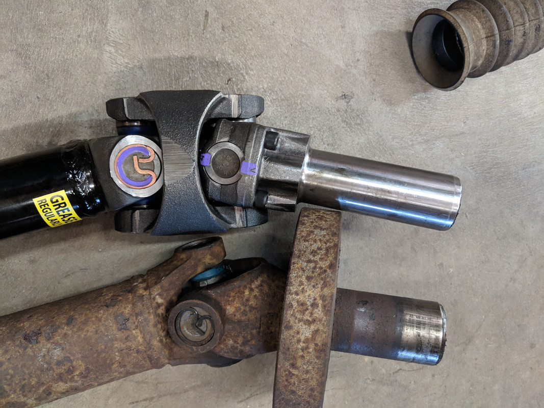

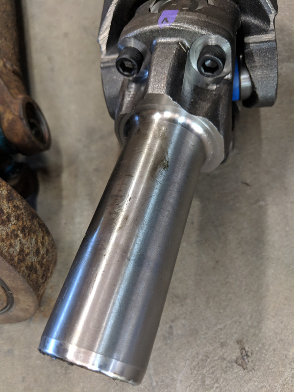

Okay so I got the driveshaft today. It is really nice, precision balanced because dabs of weld material where added to the balance dicks as need. The 31 1/4 length was correct. The cardan joint has a removable forward yoke held down by grade 8 bolts.
BUT the yoke is for a 1 1/8 inch OD shaft and ours are 1 3/8 OD. 32 spline if I'm counting correctly. So I sent a message off to the vendor in NC and will update tomorrow.

I had to send the shaft back, they built the one for the np231 transfer case. the np242 has 32 spline and they use a 3 inch torque tube. Maybe I get the right shaft in a another 7 days. will update

Here are the photos, you can see the gap I had pushing the shaft all the way forward onto the transfer case about 5/8 inch. You can see the final slip spacing after the shaft is bolted in. The measurement I gave them was 31 & 1/4 inch. I'm still evaluating it's vibration dampening.

Update on the driveshaft. It's either completely out of balance the addition of the factory rear driveshaft flange (doubtful?) or it's not right for this vehicle for some reason. The 45-50 vibration I had with the factory shaft is less under power but I have a marked deceleration vibration (in or out of gear) and a radical vibration around 75-80.
I think I own a paperweight. Will email oliver's tomorrow and ask the shop. Ideas welcome.

It may just be my eyes or some trick of the light in the photo, but if it's possible, try putting your old front slip-yoke on the new driveshaft.

I have not checked that the length of the front slip yoke will be correct (enough) to replace the new driveshaft slip yoke. It could be too long, will check but before I do change anything please elaborate on why you would attempt this change? Do you suspect the weighted disk on the factory slip yoke prevents vibration? References?
While drive line assembly is something I use to bang out (literally changing ujoints daily) it's not my preference today. Thanks for the input.
