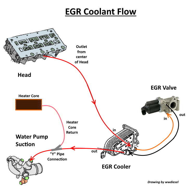

1. Reminder, the CCV requires the negative suction pressure of the turbo inlet for efficient operation and to help prevent any pressure buildup in the engine crankcase. It was designed that way by the engineers.
2. The oil drain line on the ProVent must be plumbed below the engines oil level or you will nave to install a non-return check valve for it to drain properly.
3. For coolant supply and return to the turbo, I would use the original places the EGR cooler used.
Supply, center port on head; always under full pressure of water pump discharge.
Drain, plumbed into the heater core return which goes into the low pressure of the water pump suction.
This would insure a good flow under all engine operating conditions.

Meant to post this drawing in earlier post:

Thanks for the graphic, WW!
I back-drafted the link. It seems most concerns re the EHM were cold-climate based (= freezing). At least at my current latitude, that doesn't apply to me.
