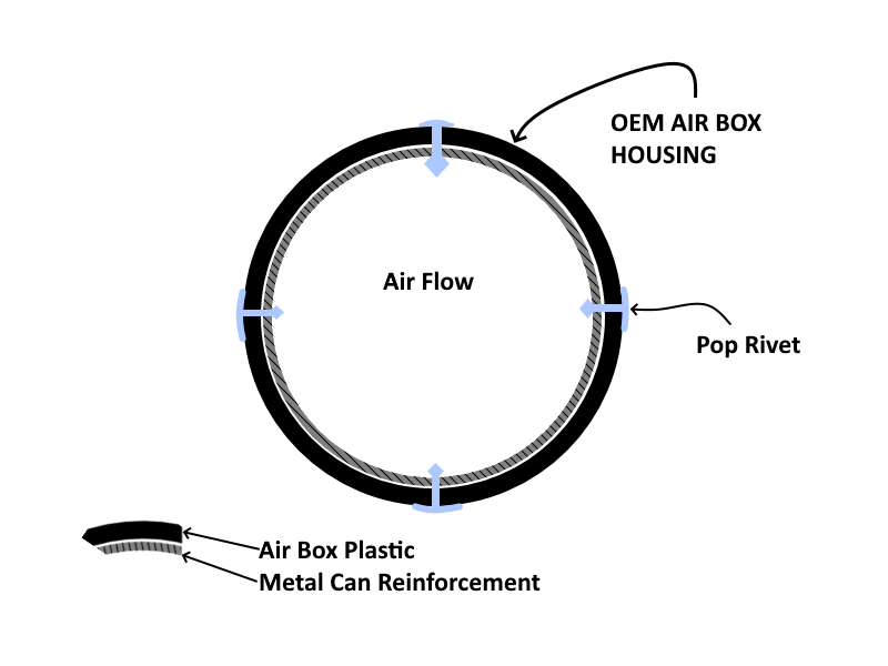

If you could find a small soup or vegetable can, cut a short section of it out and fit it inside the hose connection part of the plastic lid.
Then drill some 1/8" holes through the plastic into the metal, then use some 1/8" "POP" rivets to hold it in place. This would reinforce the critical area where the rubber turbo inlet hose clamps down. For sealing, you could coat the metal ring with black silicone sealer before inserting and pop riveting it into the air cleaner housing. See drawing for reference.
You read my mind; this is literally exactly what I was thinking of doing :mrgreen:
:BINGO:
Great minds think alike!!! :ROTFL:

That is why I suggested installing a metal liner of some kind.
Seal it all up real good with silicone sealer and nothing can break off
