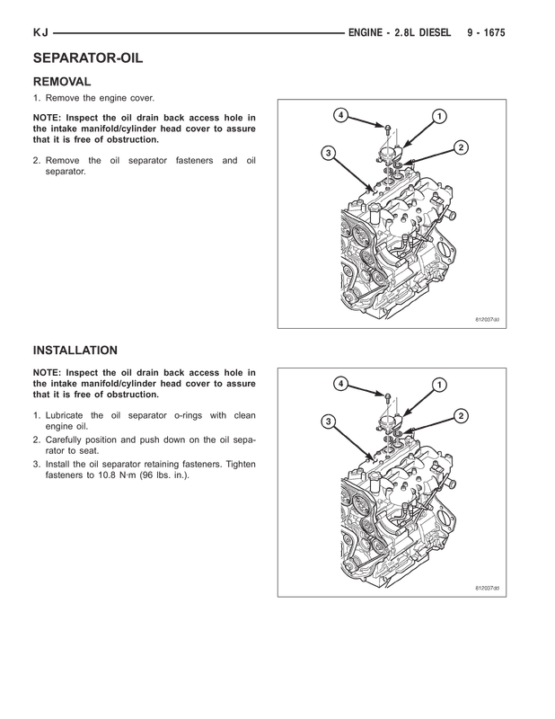

Keeping the "J tube" (loop seal) clear is very important. It is even mentioned in an obscure entry in the FSM. I believe a large number of CRD's are driving around with this clogged, hence exasperating oil carry over issues. It can be difficult to get a clogged one cleared initially, but once completed it is fairly easy to keep clean as in WWDiesel's photos. I pop mine off to clean every second oil change. Neither of my CRD's experience noticeable oil carry over now and I do not have Provents or equivalent separators installed.

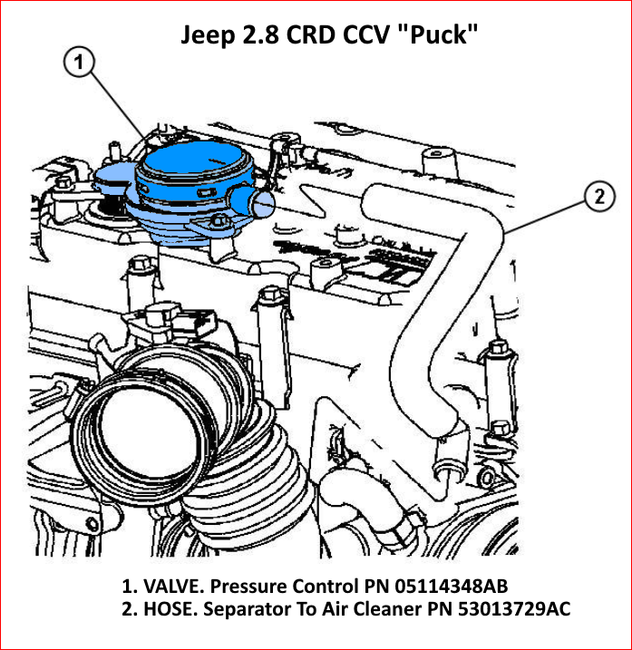

Chrysler calls it a "Pressure Control Valve".
VALVE. Pressure Control.
This Fits Your 2005 Jeep Liberty LIMITED EDITION 2.8L Turbo 4 Cyl Diesel A/T 4X4
Part Number: 05114348AB
