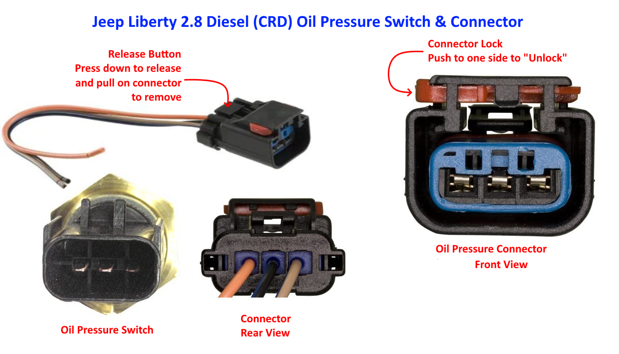

any insite on how to remove the connector. been at it for half an hour with no success. seems simple but I cant get it removed
There is a little small "RED" lock slide that you have to push to one side to unlock the connector so you can depress the release button.
After unlocking you must depress the "Release" button that is on one side of the connector and pull the connector off the oil pressure switch.
When reinstalling, push connector onto new oil pressure switch until you hear or fell the connector release button click into position, then push the "Red" lock slide lever back to the locked position. See pictures
Hope this helps!
Good luck!
Click on Picture to Enlarge!

thanks that was very helpful and the oil light went out and stayed out so problem solved
