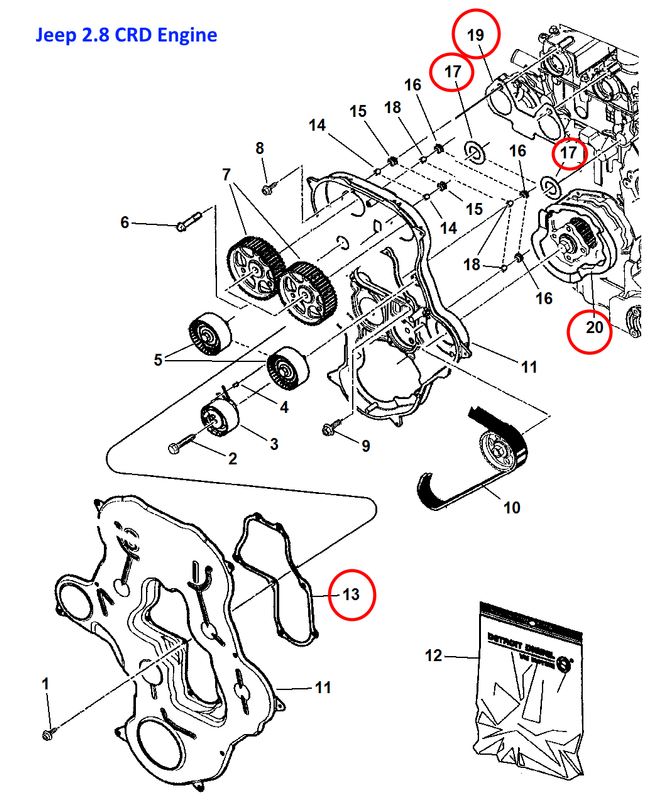

There are two (IIRC) gaskets on the inner timing cover which seal openings against the block. Does anyone happen to have part numbers for these?

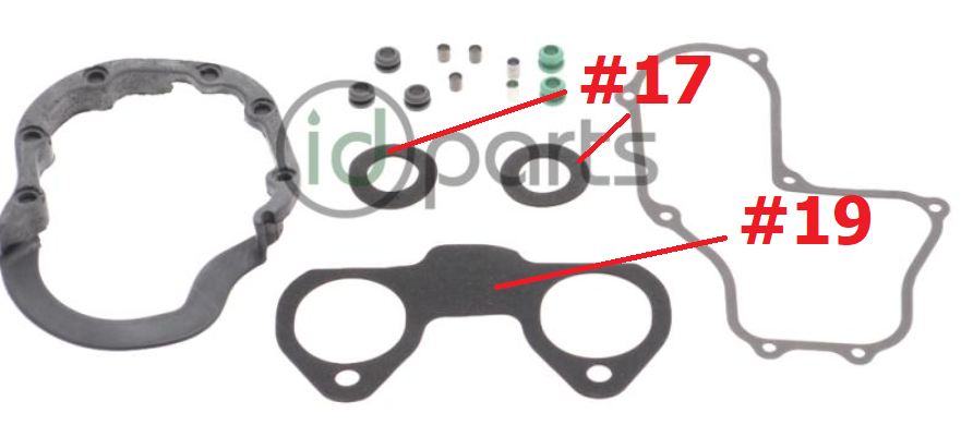

Edit: nm... they appear to be included in this kit!
https://www.idparts.com/timing-belt-gas ... -2785.html
No.
    13. 5066921AA
    20. Could not find a part number, no one seems to list it.

I'm positive it's them in the kit:
Mine have been oil soaked and are falling apart. I'm putting way to much time & money in on this to skimp on a pair of gaskets... I don't want any excuses for anything! :D
