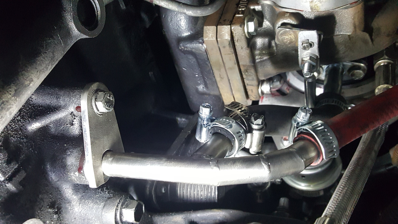

[UPDATE:
Installed:
I have a quote for $55/each for a run of 10 of the Y fittings described & pictured below. I already have a commitment for 3, but I won't green-light the run until more folks commit.
I learned my lesson last year when nobody wanted the three extra stock turbo to 3" exhaust flanges that I had fab'd, and I'm not eager to soak costs again for lack of interest. The fact that I'm not making money on these units doesn't mean that I'm eager to lose any :?
I'll gladly pack them on my dime, but each individual would be expected to cover their respective postage (originating from zip 92173).]
I'm installing a Garrett GT2560R ball-bearing turbo 'soon'.
I've already procurred all of the Oil/Water lube/cooling lines (and Turbine/Compressor adapter plates; separate turbo build thread later...).
The non-stock turbo presented a problem adapting its oil-drain to the CRD's block-port, and I couldn't locate a supplier with a usable fitting. So, while having the custom part fabricated I decided to solve two problems at once.
The resulting "Y" (in Stainless) has one hose-barb that matches the 2560's oil drain flange @ 5/8" O.D.while the other matches the Provent oil-drain's [inline check-valve] flange @ 1/2" O.D.:
Note that the horseshoe retainer permits free rotation of the tube-flanges to adapt to the ideal hose angle:
The OEM black-rubber block-grommet is just for display purposes (they're available retail @ ID/Mopar etc):
I may not be installing the turbo, provent etc. for another few weeks so I can't yet "confirm" it's actual "operational" functionality, but I can and will confirm its basic fit into the block and 'eyeball' it's flange angles to confirm their accuracy. Also, that the retaining arm fits properly (my fab guy had the 'horseshoe' retainer idea. Brilliant simplicity).
UPDATE: test-installed the Y. Great fit:
Ignore the protruding too-long exhaust stud I temp'd in to confirm the retainer-arm fit::
The turbo-tap angle looks excellent:
However, the angle from the provent-tap to the [accepted] Provent location on the strut-tower needs to be X degrees lower: observe where the stick is pointing directly up from the fitting:
They used heavy stainless for the components:
the tubing is 1.8mm/.07" and the retainer arm is 4.8mm/.19". Robust.
My own (prototype) was $70.
I have requested a quote for a run of 10. Once a quote is in-hand, if anybody wants a set of these I'll gladly supply at my cost (+shipping).
Nothing proprietary here and anyone is welcome to copy/improve the design and fab for themselves.
[To simplify the thread, I'm going to update answers to questions here rather than post endless responses ]
- Hey, Joe! Yeah, I was thinking about the stock bracket space issue. The prototype's retainer arm is overkill-thick; thinner stock might reduce the space enough to compensate by using a washer or two as spacers up/down. Also, the single mounting-hole at the turbo end of the stock bracket could be reamed slightly to allow for any required play to bolt.
- Kinugawa sells an adapter kit for the 2560; I just confirmed that the included oil drain flange fitting has the same mount as the CRD stock turbo's drain flange:
Or, you should be able to chop the upper section of the stock turbo drain tube to only a few inches long, replacing the lower section with a hose to the Y joining with the provent drain hose.
[Note the piece of black electrical tape wrapped around the neck of the stock tube; it prevents that thick stock flange from sliding down while you're wrestling with those two pugnacious mounting bolts!]
Cheers
(removed stupid "disclosure")

Just for others note, the retainer bolts to a boss that normally has the turbo support bracket bolted to it.
If someone wanted to use this for a stock setup, it would need a step put into it so that it could be bolted on the outside of the bracket, and still be able to push in the drain tube.
Using this you could then order a standard gt15-30 oil drain fitting, and use a standard drain hose. Instead of the stupid 1 piece design that is factory. For anyone who has taken their turbo out, you can appreciate how easy this would make removal.

:idea: Had a thought on this! Does the drain line for the turbo enter the block BELOW the oil level?
I think not, so if you use this "Y" design drain line you will have to add a check valve on the drain for the ProVent to prevent blowback and allow the ProVent to function correctly.
ProVent recommends for it to drain into the block below the oil level in the crankcase.

Thanks for heads-up, however I already specified "[inline check-valve]" in title post, right before pic.
Versus a simple check-valve, I'm not certain how advisable it would be to add a tap into the pan (below the oil line). Why introduce a 'thru-hull' with the potential for 'submerged' leakage? Better a 'freeboard' tap with a check-valve.
I'm not sure that this is even an issue - Think of the provent as a filter. The suction side of the provent is on the "clean" side of the filter. The inlet and the drain are both on the "dirty" side of the filter, AND are both connected to the crankcase pressure. They should be at the same internal pressure, and all you are doing is providing an additional pathway for CCV air to be drawn into the provent. If anything, the only thing I would be concerned with is that the suction from the turbo could be too strong, and where the CCV would close off (that is the designed function) the drain would remain open and potentially allow the crank case to go to vacuum. There is no chance of "blowback" from the oil drain, but maybe this question about the suction is being overthought too.
easy enough to add that into the ProVent line when you install it.
That seems weird though, because the crankcase pressure is exactly the same whether above or below the oil level. It's just harder to move the oil into the line than air.
Not only that, but the ProVent is already under pressure from the CCV in the top, so it should be balanced.
It makes sense to me why Mann wants it below oil level;
If the drain line for the ProVent is connected back to the engine to allow for continuous draining and does not drain into the crankcase BELOW oil level or at least have a one way check valve in the drain line.
There is nothing to stop the flow from reversing and actually pulling flow up through the drain line when the turbo suction puts the system under vacuum and any flow in this area would in essence totally bypass the ProVent coalescing and cyclonic action of the filter design and allow flow straight into the turbo suction which would defeat the whole purpose of having the ProVent filter system.
In my case I simply have a long drain tube with a small globe valve on the end of the tubing which allows draining at intervals. I have no desire to drain it back into the engine as the liquid captured contains things that I would not want going back into the oil system.

" I have no desire to drain it back into the engine as the liquid captured contains things that I would not want going back into the oil system. "
THAT is an interesting point. However, the stock setup has it routing back through the CAC, etc., so is looping through the provent comparatively worse?
Separately, I'm wondering if there's any argument for inserting a check-valve into the turbo's drain-line, too. Hopefully, the blow-by pressure is never high enough to compete with the oil-pump's pressure(!) It seems like a stupid, risky idea but maybe I'm missing something.

I think the Mann-Hummel check valve they make for this circumstance is all that would be needed. Just something to prevent the turbo return oil from going back up the provent drain.
