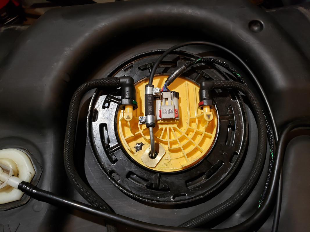

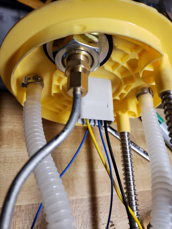

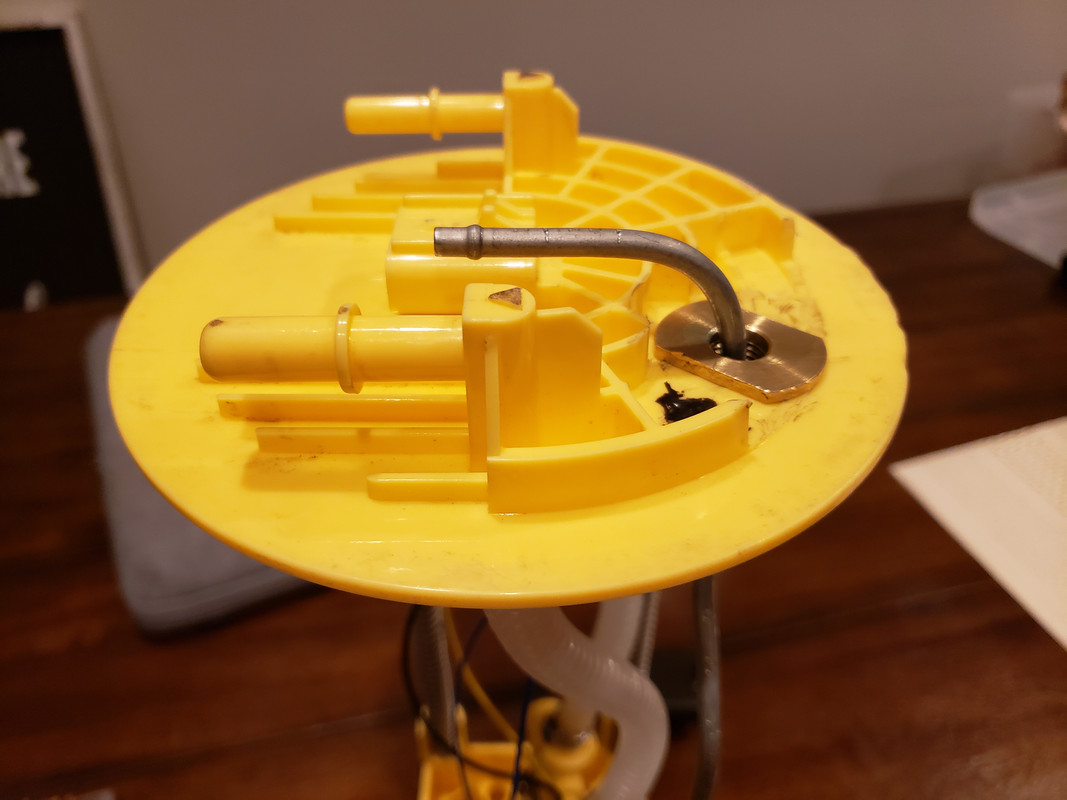

PostPosted: Mon Jan 11, 2021 5:14 pm
Joined: Tue Oct 27, 2020 2:05 am
Posts: 18
Location: Edmonds WA
This is how my lift pump with fuel tube install turned out. I got the Thermo Top Evo 5013379A kit, which seems to have everything needed to do the install in my CRD, including the SmarTemp fx 2.0.
