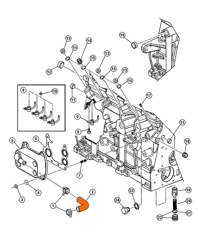

As to flushing the engine, with the head off I have no idea how this could be accomplished. Normally a complete disassembly of the engine would be required to soak the block and clean out all passageways.
Mountainman or one of the others who have extensive knowledge of the bottom end of this engine may could help guide you in this area?
See Item 9 in picture 2 below.
You could just wait until you get it all back together and use an engine flush additive in the oil running it up to normal temperature and draining the oil doing this several times. But doing it this way you always run the risk of breaking something loose and stopping up something else. It would be a gamble!!! :grim:
Piston Cooling Jets no. 9
