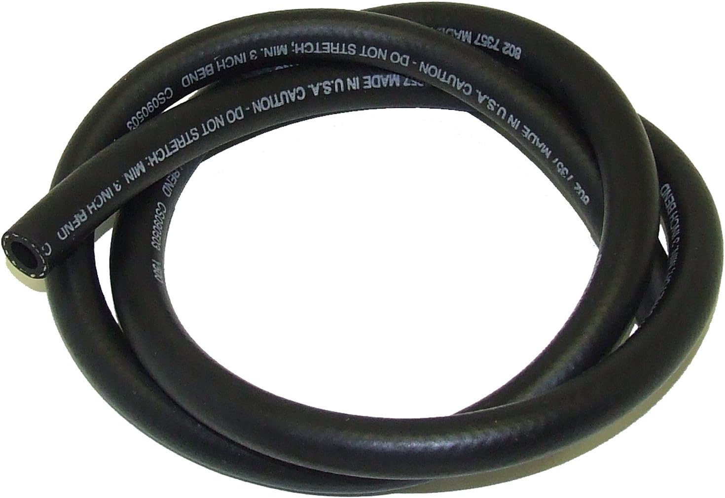

IF you replace the rubber line, be sure and use transmission rated oil line hose. It is designed for the higher pressure and temperature than regular rubber hose.

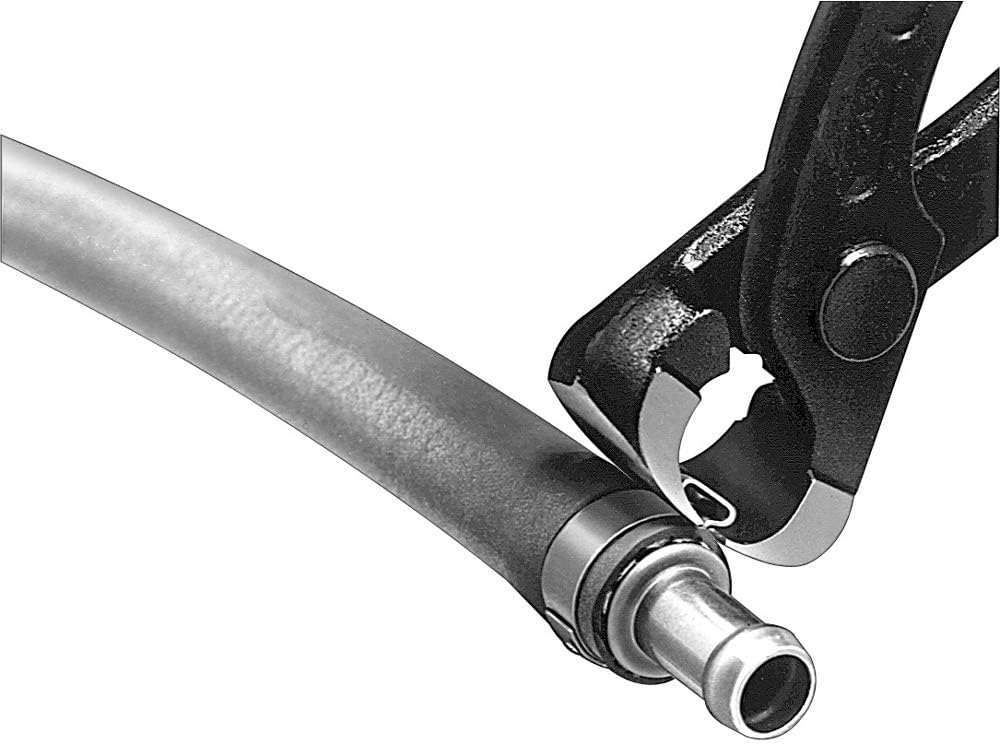

I highly recommend "Crimp" type clamps over cheap screw clamps that tend to loosen over time and leak. See picture 2
I have seen, and had to repair, when some owners replaced their hose with regular gas line hose. It will last for a very short period until the heat weakens it and it bursts. :dead:
Should be similar to this:
Hayden Automotive 106 Transmission Oil Cooler Hose

You can buy the crimp type clamps at most hardware stores or building supply stores in the plumbing section, or online at Amazon. I buy them in the bags of 10 at Lowes.
They come in different sizes.
Any "END" nipper type pliers can be used to crimp them. Just be careful and not over-do-it.
End nipper pliers are available at Harbor Freight, Hardware stores, and building supply stores or you can order them online.
