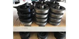

Remove the serpentine belt and start the engine and see if the noise goes away or stays.
Could be your harmonic balancer is bad and the rubber bonding is separating allowing it to rattle under certain conditions.
Physically grab the harmonic pulley and see if it is loose or has any movement in it at all. There should be NONE!
These guys rebuild them if you need it repaired as they are no longer available anymore new in North America.
Damper Doctor:> http://damperdoctor.com/
