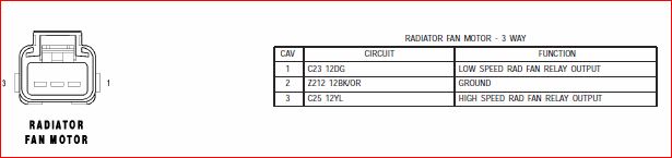

Things you have already established:
1. The fan motor will run in low speed, so the low speed circuit is good and the motor ground to chassis is good.
How it works,
The second WD below shows how its wired and controlled.
The PCM controls both low and high speed relays based on several inputs including temperature along with looking at the AC line pressure transducer to run the fan in high speed when the AC is on.
FSM page 7 - 36 ENGINE wrote:
From the FSM: The PCM regulates fan operation based on input from the engine coolant temperature sensor, air conditioning select switch and vehicle speed.
In addition to using coolant temperature and battery temperature sensor to control cooling fan operation, the cooling fan will also be engaged when the ,air conditioning system is
activated. The relay is also energized when air conditioning is selected and coolant temperature is above *95° C ( 203° F), or , air conditioning is selected. It will then de-energize when air conditioning is selected and coolant temperature is below *92° C (198° F)
*Note: These values listed above are for a gas engine and unfortunately the operational values for a diesel engine are not listed in the FSM or in AllData. I suspect the temperatures values will be slightly lower since we know the thermostat fully opens at 176 deg.s F.
If anyone has the operational temperature values, please post. I could not find them and would love to have them!.
things you can check with a 12v test light or volt meter.
1. Check terminal 30 for the high speed relay and make sure you have 12v
2. If you jumper terminals 30 to 87 at the high speed relay plugin, fan should run on high, if it does not continue with checks
3. with terminals 30 to 87 jumpered, check to see if you have power at the cooling fan connector (terminal 3 in the connector pinout pictured below)
4. If you have 12v at the connector for the cooling fan with 30/87 jumpered and the fan motor does not run, the motor is bad for the high speed windings.
How it works,
Neat diagrams and description from WWDiesel :wink:
The FCM is always a big suspect as the connector gets all gunged up with dirt.
Watch out for the "C" connectors such as C111 etc. Worth re-plugging the relevant ones a few times. The various splices can also introduce external issues.
Definitely test the motor by jumping relay pins 30 and 87 together.
How it works,
Thanks for the reply, I have checked the 4 things you mention, 1. Yes 2. No 3. Yes 4. Yes, I agree
I will relace the fan motor and go from there, any current thoughts on the best replacement for the Mechanical Fan Clutch, new clutch or Flex fan or?
