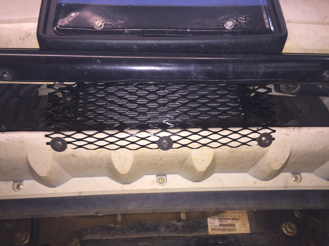

The reason its hot-ish is the block w/sensor is located in the fluid line right after it comes out of the transmission going TO the fluid cooler up front.
So the fluid being read is at its hottest temperature.
I also added a 10 plate stacked auxiliary cooler in series after the OEM cooler.
May not have been the best location, but I read pan mounted sensor is not very indicative of actual fluid temperatures?
In its current location, it reacts very fast to changes in loading or the fluid being "worked" harder like in city stop and go driving.
Guess I need to install another block with sensor in the return line with an inside switch so I can see how well the coolers are functioning?
This is the in-line block w/sensor:
front mounted 10 plate stacked cooler:
