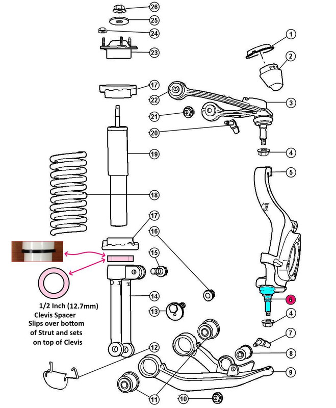

IronMan or OME kit which includes springs and struts/shocks
or
buy springs by themselves and order Bilstein Shocks
then
add 1/2" clevis spacers between strut and clevis, with any of the above.

BC_CRDtom wrote:
This is for use, I already push her to her limits, the undercarriage doesn’t like me.
Thanks for the purchasing suggestions. I’d like to try and buy Canadian so avoid virus duty fees and long ship time if possible.
Does that clevis spacer you mentioned allow for more clearance off the CV axles?
Clevis spacers or strut spacers that go on top of the strut simply give you more lift of the body off the suspension which in turn gives you more room for larger tires.
This is provided you have stronger springs like the IronMan or OME springs.
Where is your CV axle hitting the clevis?
Clevis rings go between the strut and clevis or strut fork and gives extra lift on the front end. These rings can be used to lift and level the front end of the Jeep with the back end.
.250" Clevis Spacer = about 1/2" of lift.
.375" Clevis Spacer = about 3/4" of lift.
.500" Clevis Spacer = about 1.0" of lift.
https://jbaoffroad.com/clevis-spacer-fo ... truts.html
Some simply stack some 2" metal conduit nuts together to make clevis spacers. :D
I made mine out of 1/2" steel square stock, heated it, bent it in a circle, and welded the ends together.

Mountainman wrote:
Why does the clevis lift give 2x, and how does the top-plate compare? I've never read that either are better than the other, but always figured that one would be a little better...?
Geometry is the reason Mountainman.
The clevis is mounted to the LCA about 1/2 way back towards the pivot point so any change is doubled at the wheel. I think the KK has longer clevis, dont know if you could use them.
Top plate/clevis is a matter for personal preference unless some one knows otherwise.

Just like layback40 stated, it is due to the geometry of the relationship between the pivot point of the clevis versus the lower control arm. Due to its location, any additional increase in the length of the strut/shock/clevis will double in height at the front axle spindle.
I have no experience on top plate spacers for this particular vehicle as I have never installed any.
But I have used top plate coil spring spacers similar to them on Dodge 4x4's trucks that came in lift kits and they work very well on them. :D

There is some strategy to it. Do the top plate first if you can because it is a little harder to do later if you get everything on the ground and realize you want to add a little more lift in the front. A clevis lift can be done relatively easily and without spacers if you want. The early cast iron style KK forks are about 3/8 longer and do fit a KJ with some minor grinding on the lca bushing.
