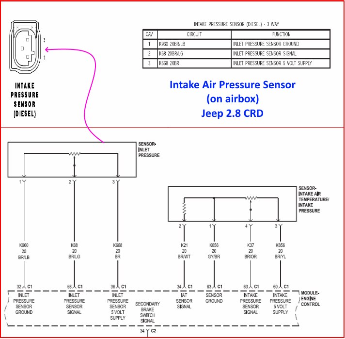

I n the pin out to check the wiring to the pcm. Thanks

 Post subject: Re: Air Box Sensor
PostPosted: Mon Feb 21, 2022 1:47 pm
Posts: 7390
How's this?

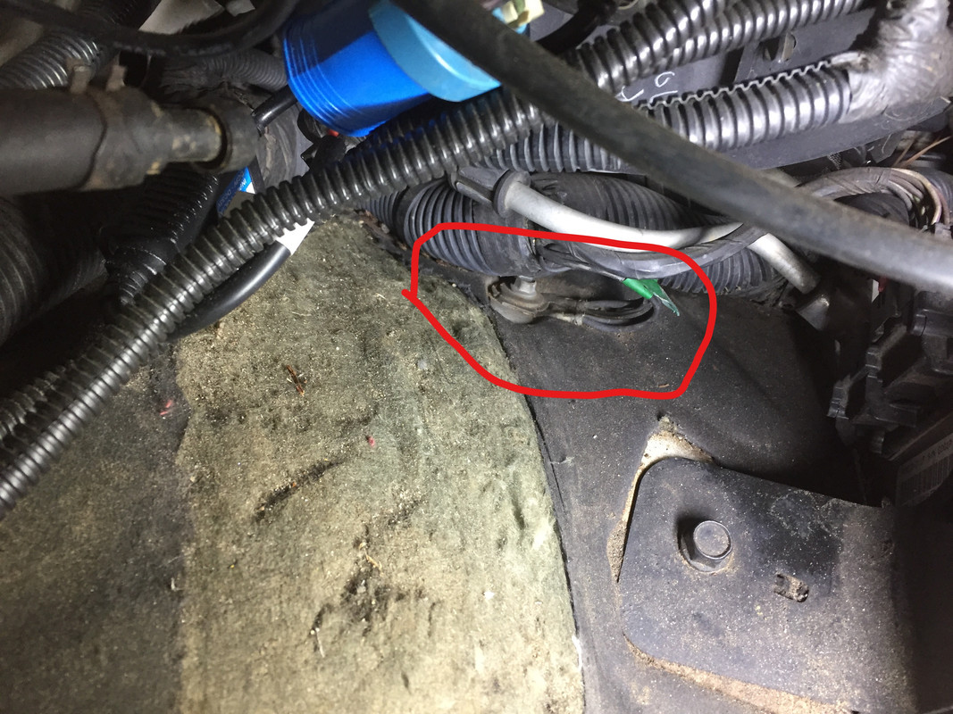

Thanks for all your help. It has speed things up. When look at some schematics I was looking at and I'm trying to locate the body ground point. It says it is located left rear of engine compartment. States it is a black/dark green wire. Any pics or help fining this?
PostPosted: Mon Feb 21, 2022 10:18 pm
Posts: 7390
Which ground, there are quite a few of them? Do you have a ground number like G102 or one of the others?
All the ground locations are shown in the FSM for the 06 in section 8W starting on page 26.

Looking at the FSM and the schematics I think I'm looking for G100. I'm looking for the ground point of the ground wires coming from the PCM to the body
PostPosted: Tue Feb 22, 2022 12:10 pm
Posts: 7390
I believe that one is located on top of the inner fender behind the left headlamp (drivers side).
There are several grounds attached under a bolt at this location.
