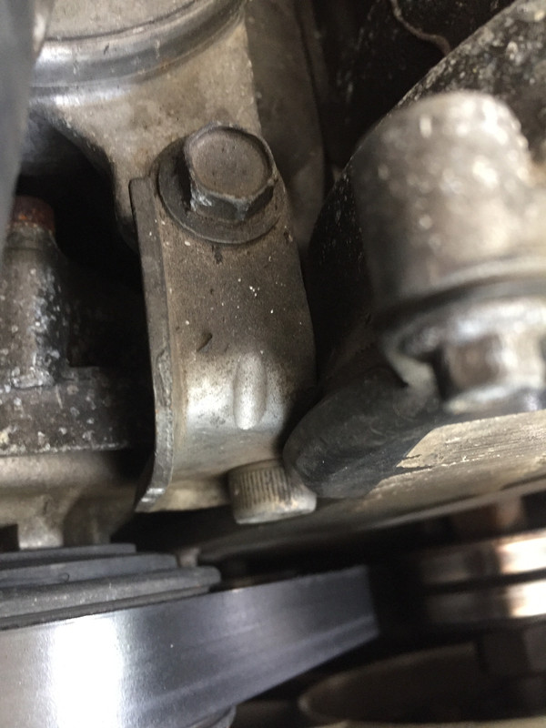

Took a closer look at that viscous heater looking for alignment possibilities and found this cracked bracket:
Hmm. Any thoughts?

You should remove the two pieces, take them to a welding shop and let them weld them back together or have them fabricate a new bracket out of thicker metal.
If it me, I would just build a new heavier duty bracket.

That bracket is virtually useless and does nothing for holding the VH in place.
The VH is actually bolted to the water pump.
So, if that bracket is broken, what’s going on with the water pump?
Also, I’d take another look at the belt tensioner.

Good question. Took the belt back off and the VH and the mount behind it (aka the water pump) will readily move fore and aft. Safe to say the Jeep is not moving til this is fixed.
I have the parts on hand for a TB service, to include a new graf pump. Guess that all just moved higher on my list. Any other suggestions?

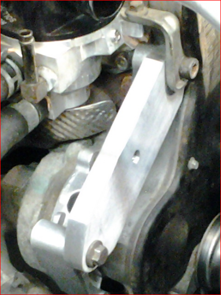

What pulley (PN) did you use, Gates 36167?
Waiting a new thermostat from Jeff that I ordered to arrive.
Once I have it in hand, I plan to totally remove the Viscous Heater and associated hoses and design a billet bracket to hold the pulley.
I would like to make something similar to this:
*picture provided by a LOST member.

Found the cause of my problem today. The outboard bolt securing the VH to the water pump was missing. The little bracket that connects to the thermostat and the inboard water pump bracket arm were broken.
I suspect this bolt has been missing since the last TB service which the PO reported was about 50K miles ago.

Update - it's almost back together now after new timing parts, water pump, rockers and arp studs. A friend welded the broken bracket for me and I actually found the original missing bolt laying on the front skid plate!
