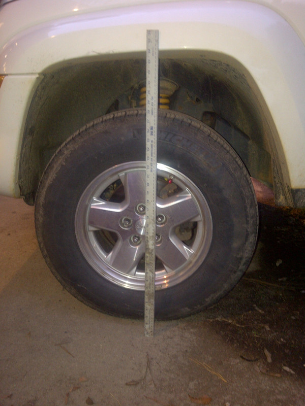

Sorry it took so long to get pics. Had to do the research on how to post images here. The wheels seem to have a different offset from the stock wheels and they appear to sit further out from the vehicle. the inner plastic fender has been trimmed from PO and more from me but it still hits now and then. The front end does seem to sit lower, not sure if it is tired suspension or that it normally sits that low. It appears from the measurements I have that the center of the wheel hits at 15 inches and the top of fender at 32 (or 17 from center of wheel to top of fender-seems I read somewhere that stock was 19). Maybe just a stock replacement would suffice.

Those front strut assemblies came with springs that look like they were meant for a gasser liberty. The 2.8 diesel engine is quite a bit heavier than the 3.7 and requires a stiffer spring. That's part of your rubbing issue. The other probably bigger part is the increased turning arc caused by the offset in your wheels. I experience this arc phenomenon with my setup too (1.25" thick wheel adapters and wheels from a jk). My tires (245/75/r16) are about even with the outside of the plastic fenders.
You might be able to fix it by lifting the front end, but my experience is that it will just move the rub spot down until you have applied enough lift to clear the forward most part of the tire under the front fender liner.

So it sounds like I will have to go more than stock and lift the vehicle some. I know some that started changing the upper control arms and other parts due to geometry changes at 2.5". Is there a point where I won't have to worry about other part upgrades, say 1.5" or less?

You can go to 2.5" of lift with 245/75/16 tires on stock backspacing wheels and stock control arms and not have any rubbing problems.
Your biggest problem is your aftermarket wheels backspacing is causing the tires to rub due to the larger increased turning arc of the tire on the higher offset wheels.
Go back to stock 16" wheels with OEM backspacing along with a 2 - 2.5" lift and you should be OK.

Don't go abandoning your wheels just yet. They may be fine if you can get your center of hub to fender measurement to 20+ inches. You should be able to achieve this a number of ways, but either the Iron Man or OME options are the most widely accepted and available. Neither option on its own will require new CV axles or UCAs. Worst case is you get your new front suspension and you still have unacceptable rubbing. Next step in that case would be add a little more lift via top plate or clevis if you can. If that is no good, find a different set of wheels. :2cents:
I'm sitting at 20.5, probably have a very similar net wheel offset and my tires are bigger. The tires just kiss the front inner fender liner at full lock.
