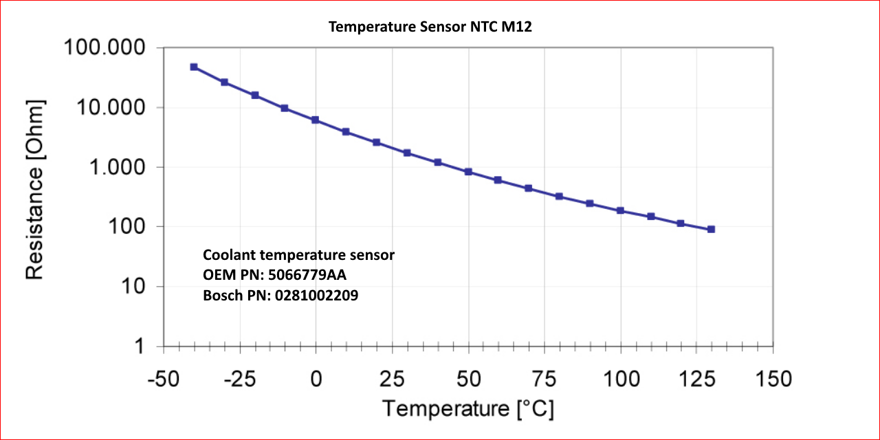

PostPosted: Thu Dec 24, 2020 10:14 pm
Posts: 7390
These are the part numbers I have on file if it helps any:
Coolant temperature sensor
OEM PN: 5066779AA
Bosch PN: 0281002209
 Post subject: Re: ECT Sensor
PostPosted: Thu Dec 24, 2020 10:39 pm
Posts: 652
That Bosch part number may be key - thank you! Mine has no part number other than the Mopar one. :(
Edit
Likely this:
https://www.bosch-motorsport.com/conten ... =53698955/
With CATCRD's values I get a beta of 3530, and with Bosch's values I get 3517. Definitely within an acceptable margin of error!
PostPosted: Fri Dec 25, 2020 2:58 am
Posts: 7390
Love the chart, it tells all.
