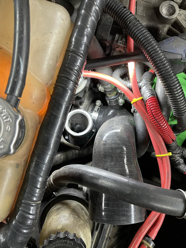

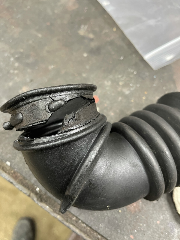

If you have not done so lately, you may need to check your turbo inlet hose/boot for cracks.
I recently purchased the Samco silicone turbo inlet hose/boot from SasquatchParts.com while Seth had it on sale.
Good thing I did, when I removed my OEM rubber hose, it was cracked and busted.
I may have busted it when pulling it off the turbo, but it definitely was soft and rotten!
I replaced it about 5 years ago when I installed the ProVent 200 filter/separator.
The Samco silicone turbo inlet hose/boot is by far a superior product and should last for a very long time.
Hopefully oil vapors will not affect it much.
New Samco silicone hose installed:

Looks great WWD!
Can I have your permission to use your photo of the factory hose on SasquatchParts.com?

Yes, sure, use it! If you need some more, let me know.
Thanks for providing us with a much better and improved option to replace the flimsy OEM rubber intake hose that seems to rot out every few years! :BANANA:
