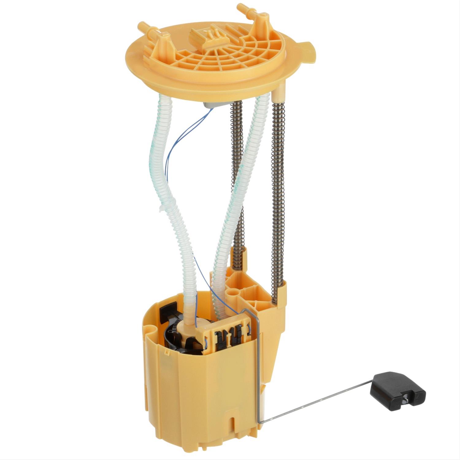

The Delphi FT4015 module does not have a pump, it is only has a pickup tube and fuel level sensor. (2 wires) See Picture 1
The Delphi FG1224 module has a 12v fuel pump in the housing along with the fuel level sensor. (4 wires) See Picture 2
Picture 1 -- Delphi FT4015
Picture 2 -- Delphi FG1224

Ok ,thank you
so I can do the replacement without problems ...
Giacomo
