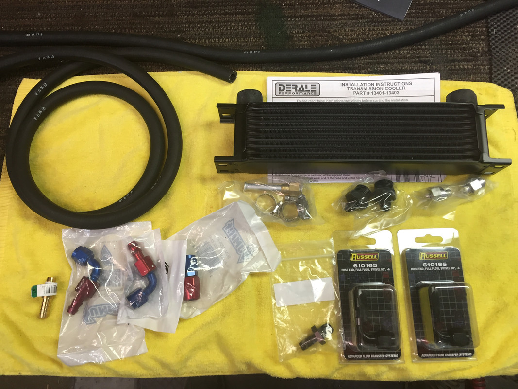

This is what I used. A Derale 10 plate stacked transmission fluid cooler with AN fittings.
It fit the opening perfectly under the bumper and I liked the super reliable AN fittings so I don't have to worry about leaks. See pictures below.
They also have remote coolers with thermostatic controlled fan if you want to put the cooler somewhere else.
Purchased it from Summit Racing along with the AN 90 deg. hose fittings.
The absolute biggest improvement I found was installing the deeps sump PML finned aluminum transmission oil pan, it dropped the transmission oil temperature ~40 degrees when towing a loaded trailer. Worth every penny I spent on it and I wish I had done it several years ago.
It took 9 quarts of ATF to refill transmission when I installed it. Volume does make a big difference.
It only added about 2 inches more to the bottom of the transmission.

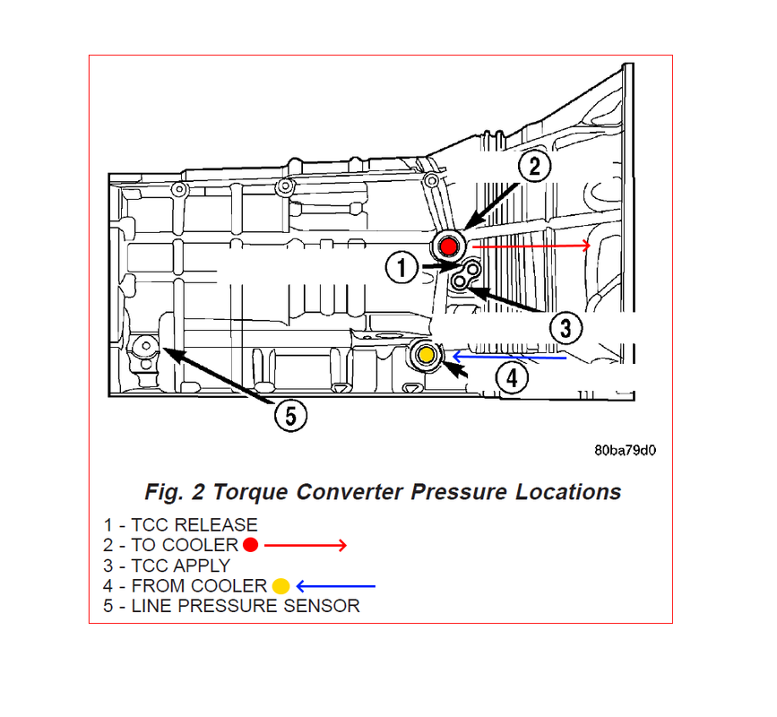

That's pretty much the install I'm looking at doing. Are you using only the external cooler, or did you retain the factory cooler as well? Where are the inlet/outlet? On the top or the bottom?
 Post subject: Re: Murphy's Leak Law
PostPosted: Wed Jun 16, 2021 5:59 pm
Posts: 7400
Using both coolers, in series with the OEM, OEM first and Darale second.
Inlet and outlet are both on the top of the cooler so there would be no drain back issues.
Cooling line locations on the transmission:
