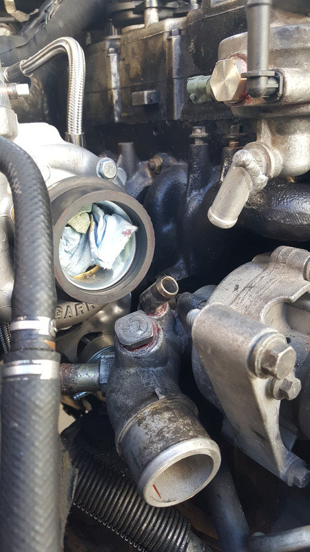

I'm trying to wrap some coolant system mods:
1. If all heater settings are "Off", is there a bypass at the heater core or when "Off" is all coolant flow blocked between the two hoses feeding the core? Anybody happen to know which direction the coolant flows to/from the core [left/right hose @ firewall]?
I want to insert my [h2o-cooled Garrett BallBearing] turbo coolant-line into a heater-hose path. If there's a bypass at the heater core than there'd always be flow, if not I have to relocate the insert location.
Pic:
2. Thermo closed, which ports are DIRECTLY pressurized by the water pump? Thermo open?
I suspect the pump only directly "pushes" through the engine port and all others are "downstream", but maybe not.
3. Years since Sasq I&II, I can't recall where the coolant port is from the egr to the block on engine-left. Is this bolt the coolant plug? If not, what/where?
Anybody know the flow-direction?
4. Unrelated: anybody know if "Removable Front Headrests" was an OEM option for ANY '05 Liberty?
Many Thanks!

You guys are friggin' awesome.
So:
1. Coolant flows constantly through heater core regardless of control settings. K.I.S.S: makes sense, less complicated.
2. Egr coolant plug identified.
-ish: shouldn't there only be one [supply] tap out of the block, given that the other line [originally] "Y" 's back inline near the thermo spaghetti?
3. Flow directions confirmed: water pump only "pushes" into its port feeding the block. All other lines & ports are downstream in the coolant loop.
I will still need to decide which side of the heater core is more advisable for the turbo's coolant line insert, but as long as there's constantly flow across both taps it probably doesn't much matter.
Re idea to restore the hose loop out of the plugged egr block-tap in order to reduce head temps... maybe, but I'm not sure truly necessary. As long as the other coolant system components are functioning properly the system should maintain correct, component-safe temps, no? I suppose it would permit engine-heated coolant to circulate out of the head more quickly.
The original routing through the egr could only have elevated the coolant temps looping back to the thermo housing, so good riddance.
On paper, I should be rolling within a few weeks (after 10 months down!). After, I'll post a thread detailing the turbo install, intake/exhaust mods, fan mods, provent mods, airlift install, tri-function gauge install, single-din pioneer dvd w/pop-up screen (& hitch-guide cam!) w/dual-amp 8-speaker upgrade, and uppity neoprene seat covers. Yeah, I've been messing with stuff since my original turbo started blowing last March...
I Advise Against Replicating My Misery!
Many, Many Thanks!
[KISS= KeepItSimpleStupid]
'15: bought '05 w/138k.

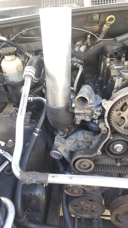

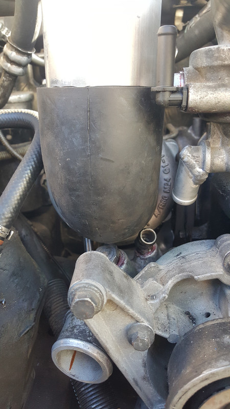

PostPosted: Sun Feb 02, 2020 4:55 pm
Posts: 450
Location: North America
Flow Engineers: Free Beer!
So, it occurred to me that flow-VOLUME is being notably reduced due to the plugs (circled) inserted into both the thermo & pump housings. They represent a delete of the direct-feeds to/from the heater-core. The hc re-route is going to travel: oilcooler-hc-turbo-pump.
[The red line just illustrates the bypass-routing]
I'm wondering how the decreased volume is going to impact system performance. First, it seems like it will only be a factor thermo-closed. Thermo-open, the volume of flow through the radiator should easily exceed any constricted-volume concerns created by the two plugs.
Thermo-closed, in response to constricted flow-VOLUME the unchanged pump-force should result in elevated flow-PRESSURE, no?
How do folks think that Increased flow-velocity will impact the system?
Faster operating-temps from cold?
Thanks!
[Add'l notes: there are both fine & coarse threads for the hose-barb fittings tapped into the pump-housing, making interchangeability of barbs (& plugs) a pita. Also, the bypass-barb @ the thermo-housing is cast alum. not removable; angle-mod required cut/weld.]
A few more pics with the pump-housing & thermo installed.
The 3" turbo intake is just temp'd in:
Imagephoto upload sites
Imagebest image hosting
Bonus Question: do the forces of Volume and Pressure exist in the vacuum of Outer Space?
