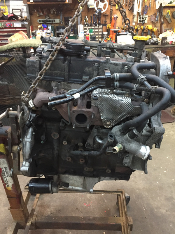

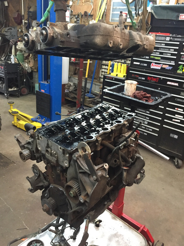

I have had many engines mounted to my four arm engine stand over the years, even some big heavy V8s.
I mounted a VM Motori to this same engine stand with no trouble.
I simply used some long 3/8 bolts with flat washers and nuts to mount the arms to the rear engine adaptor plate.
See Pictures:
Image Image Image

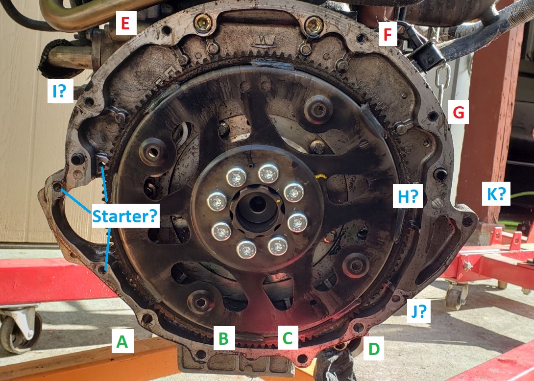

Picture of back side mounting plate:

Best I can tell from looking online, the bolts that mount the adaptor plate to the back of the engine block are M10 x 1.50 mm
So you would use M10x1.5 bolts of the correct length for you particular engine stand support arms.
If you have an engine available, it would be very easy to verify the bolt/thread size for these six threaded holes.
If this size is not correct, hopefully someone post the thread size.
These are the OEM PN's according to a couple of the Mopar Sites: 68516518AA, 05003532AC
There are six locations as pictured below that can be used for engine stand support arm mounting locations.
This same pictures applies to the 2.5 diesel engine as well.
My engine stand only has four support arms for mounting to block/engine.
Personally I like to try and mount the support arms where center of mass/weight is as close as possible to the engine stand's rotation or pivot point. This makes rotating the heavy engine much easier.

thesameguy and WWDiesel:
Thank you for your responses... both of your latest photographs are VERY helpful.
WWDiesel, where did you get your photo? This looks like a photo from an official source; if it is, there is a good chance the source of that photo will have the specifications for the engine stand mounting location bolt holes.

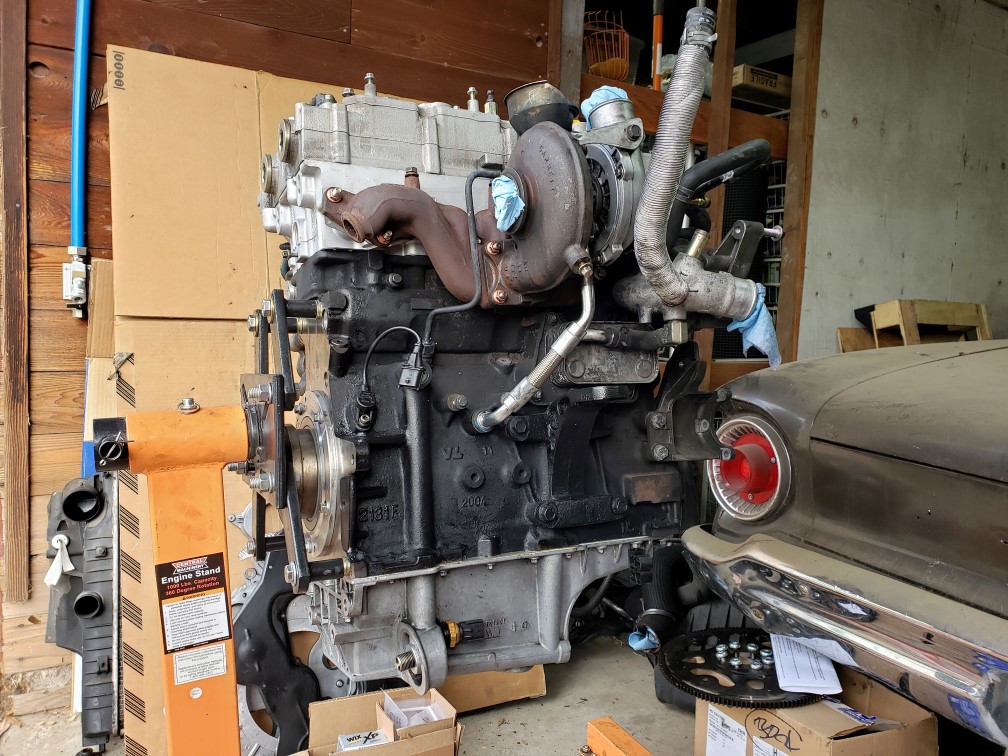

Here is the engine stand I purchased that the adapter bolts to:
https://pdf.directindustry.com/pdf/wern ... 40640.html

The picture with labels you asked about, I did myself.
The thread sizes I supplied to you I was able to find online.
Engine stands are NOT engine specific, they are universal and the end end user is responsible for figuring out what bolts are needed to attach the mounting arms to the engine block. It is not that hard and I am sure you will figure it out once you get your hands on a block.

I received information from one of my Model 001 customers who helped me to secure the RA428 engine in Michigan. He went and personally inspected the engine he has in storage for me. It turns out that the engine block bolt hole specifications are M10 x 1.5 and M12 x 1.75. The expensive Werner-Weitner engine adapter kit components will work on V.M. Motori engines. This was the whole point of getting answers from people through LOSTJEEPS.com and through the Jeep Liberty CRD Facebook Page... to see if the engine adapter components will work. Here is the link to the engine adapter I purchased; specifically, I purchased the WW-6-140K...
