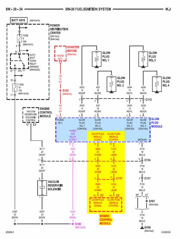

So, if the "module" is nothing more than a relay, then it would seem the ECM is actually controlling the voltage.
Yes, it is a very different type of
relay/module and is controlled by the ECM based on programing/maps stored in the ECM's memory.
I am sure Yeti, aka Marco Giacomelli, could better explain in detail how the maps are programed for control of the GP module and ultimately the Glow Plug Voltage and time spans.
I suspect the ECM just provides a switching voltage, that is, its on for a part of the time at 12v and off the remainder of the time. Doing this at a reasonable frequency would result in an average voltage of about what is set.
I wonder what would happen if some one removed the ECM supply and replaced it with a 12v supply from the battery?
A part from shortening GP life, they would heat up quicker.

I wonder what would happen if someone removed the ECM supply and replaced it with a 12v supply from the battery?
You would probably burn them out in short order. They cannot withstand 12v for any length of time.
From manual:
When the ignition is turned on, the ECM activates the glow plug relay for a time period that is determined by engine coolant temperature, atmospheric temperature and battery voltage.
The GP module/relay is wired 12v hot all the time, the voltage going to the glow plugs is pulsed by the ECM based on the 3 above input values it receives.
The module is pulsed by the ECM via a grounding circuit and feedback it receives from the GP module.
Adding a manual switch would be of no use since is already supplied 12v all the time.
See wiring schematic.
