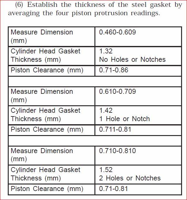

Posts: 7390
krb wrote:
I thought you were supposed to match the new head gasket to the one you removed? Why do you recommend using the two hole automatically?
Head Gasket thickness selection is based solely on the measured top dead center piston protrusion versus piston liner position.
From the Jeep 2.8 CRD Factory Service Manual on Head Gasket Selection wrote:
Section 9 - page 220, 2.8L COMMON RAIL DIESEL ENGINE KJ
If one or more liners have been replaced the liner protrusion must be measured to determine the proper head gasket selection.
If the liners are not removed, use the same thickness head gasket that was removed.
KJ 2.8L COMMON RAIL DIESEL ENGINE Section 9 - Page 195
If the liners were removed:
(6) Establish the thickness of the steel gasket by averaging the four piston protrusion readings.

FSM says it is a multi-layered steel head gasket.
As to head gasket thickness selection, please study the facts, there is a reason for providing different thickness head gaskets. A one size fits all may be doable, but it may not be the best choice based on the factory recommendations and recommendations by other parts suppliers:
From IDParts web page: wrote:
Cylinder Head Gasket Kit for the Jeep Liberty CRD. It is important that the correct cylinder head gasket size is chosen. The gasket size is stamped into a tab that is on the intake side of the engine between cylinders 2 and 3. Look for a tab that has a part number stamping on it. On the rear-ward end of the tab may be some circular holes. The tab can have no holes, 1 hole or two holes. The sizes are as follows:
No Holes - 1.32mm Thickness
1 Hole - 1.42 mm Thickness
2 Holes - 1.52 mm Thickness
Head Gasket thickness selection is based solely on the measured top dead center piston protrusion versus piston liner position which can affect piston to valve clearance when the piston is at TDC and the valves are in a transitioning condition.
If one or more of the liners were removed/replaced: See KJ 2.8L COMMON RAIL DIESEL ENGINE Section 9 - Page 195
See the above previous post for the thickness selection charts:> viewtopic.php?p=945580#p945580
 Post subject: Re: End of my good luck
PostPosted: Mon Jan 04, 2021 4:08 pm
Posts: 652
Which FSM are you reading? The '05 manual says:
NOTE: If cylinder liner(s) have not been removed,
can be used.
(1) Clean and inspect gasket mating surfaces.
(2) Position correct head gasket on engine block.
(3) Place cylinder head on engine block.
CAUTION: New cylinder head bolts must be used.
Do Not lubracate new cylinder head bolts. They
already are coated with an anti scuff treatment.
(4) Tighten cylinder head bolts following procedure
below.
(Yes, it says LUBRACATE - lol!)
The '06 FSM says:
NOTE: If cylinder liner(s) have not been removed, the same thickness head gasket that was removed can be
used.
1. Clean and inspect gasket mating surfaces.
2. Position correct head gasket on engine block.
3. Place cylinder head on engine block.
CAUTION: New cylinder head bolts must be used. Do Not lubricate new cylinder head bolts. They already
4. Tighten cylinder head bolts following procedure below.
(they fixed the typo! :D )
I would definitely not go offroad with head gaskets - the specific thickness is there to make up for fine machining differences of the head. With the tolerances involved in a high-compression diesel engine, there isn't room for error. I'm sure you can substitute a 2-hole for 1-hole, but there will be a slight drop in compression as a result. Probably nothing more than age has taken away. :) Going the other way could be catastrophic!
PostPosted: Mon Jan 04, 2021 7:04 pm
Posts: 7390
My bad, you are correct, got on wrong section of the FSM somehow. :banghead:
Updated the post.

6. Now needs front of engine items and accessories reinstalled, intake and intercooler tubing reinstalled and coolant system reinstalled and leak tested.
7. Biggest pain so far has been turbo reinstall and getting the intake/camshafts back onto the head without disturbing the rocker/lifters. This took two people because we still had the wiring harness going across the top of the engine so we had to carefully maneuver the intake under the wiring but still keep it high enough that it didn't disturb the rocker/lifters....it took about three tries to get it right.

Thanks for the update!
Did you have the timing cover on for the test run? My timing mark moved a tad after my test start.
You're getting there. Now's the "easy" part - as long as you remember where everything goes...
