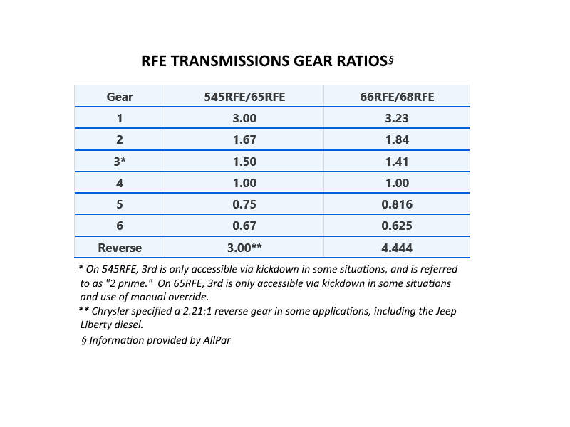

It is possible to mate up a 6-Speed automatic transmission, (68RFE), to the Liberty CRD? Am I reading this correctly? Is there a smaller jump between the gears, or does the 68RFE provide a taller overdrive for lower RPMs at highway speeds?
 Post subject: Re: trans swap
PostPosted: Tue May 03, 2022 1:52 pm
Posts: 7390
TURBO-DIESEL-FREAK wrote:
Hello, WWDiesel:
There is also a 65RFE & 66RFE that came in some Dodge/Jeep products.
Based on what I have read, Provided it is a 545RFE, 66RFE or 68RFE transmission from a 4x4 Dodge or Jeep, it should bolt up to the Jeep Liberty 2.8 engine.
The problem is solenoid pack and range sensor plate compatibility as described in what I posted earlier.
The TCM in the Jeep Liberty is not programed to utilize the 6th speed in the 68RFE, so you wound have to use a TCM from a Dodge or Jeep vehicle to make use of the 6th gear.
5th gear differences are 0.75 vs. 0.816 for the 545RFE vs. 68RFE respectfully.
The 68RFE does have the taller OD 6th gear of 0.625.
I am not sure the 2.8 VM engine has enough torque to adequately utilize the much taller OD gear, especially in hilly terrain.
I certainly am no expert in this area; I would consult with a good expert transmission person before trying to use a 66RFE or 68RFE transmission in the Jeep Liberty diesel vehicle.
I do have a good friend who is a long time certified Chrysler/Dodge/Jeep dealer transmission expert that I defer all my transmission questions to, he works a large local CDJ dealer.
AllPar has some good information & writeup comparison of all the different RFE transmissions:>
https://www.allpar.com/threads/the-45rf ... ms.230023/

WWDiesel:
I am trying to wrap my head around this topic.
I never heard of either the 65RFE or the 66RFE. What are their applications?
Your chart lists both the 545RFE and the 65RFE are being 6-speed automatic transmissions. This may be the case with the 65RFE, but how did the 545RFE grow an extra gear? Is this a case where the 545RFE is a 5-speed and is simply patterned directly off of the 65RFE?

Technically the 545rfe is a 6 speed. Same transmission, just different software programing. :BINGO:
Jeff,
I know it gets a little confusing but read on. And there is a lot of reading available online about all these different transmissions and their gear ratios.
The number of gears in the transmission is basically only a function of computer software programing.
The confusion comes in with that 2nd Prime Gear which adds the extra gear ratio in the 545RFE but is not used or counted in normal upshifting but rather is only used when downshifting. Thus the 5 speed designation for the 545RFE. But with the right software programing, the 545RFE could be forced to use the 2nd Prime Gear during normal upshifts which would in essence turn the 545RFE into a true 6 speed transmission. :D
The 6 speed is only a 1999 4 speed Jeep transmission based on the old tried and true Torque Flight transmission, with a different torque converter & different computer software programing, over the years it has been called a 45RFE, then a 545RFE, now a 65RFE & a 68RFE.
Some of the newer Ram and Jeep powertrains now have a ZF 8 speed transmission.
The 65RFE was used in trucks (behind V8 gas engines). The 65RFE was introduced for the 2012 model year, the 545RFE was recalibrated and introduced as the 65RFE; it appears in the Dodge Durango, Jeep Grand Cherokee, and Dodge Ram 1500 with 4.7L and 5.7L engines.
The 65RFE transmission hardware is identical to the 545RFE, and thus the gear ratios are identical to the 545RFE. The transmission still operates (in Drive) as a 5-speed. But if you use an Electronic Range Select (ERS) shift control, you can manually limit the top gear to any of the six possible ratios:
    • 1st gear = 3.000 ratio = ERS "1"
    • 2nd gear = 1.667 ratio = ERS "2"
    2nd Prime gear = 1.500 ratio = ERS "3"
    • 3rd gear = 1.000 ratio = ERS "4"
    • 4th gear = 0.750 ratio = ERS "5"
    • 5th gear = 0.667 ratio = ERS "6"
    • Reverse = -3.000 ratio
The 66RFE is a modified gear ratio transmission used in 2500 and 3500 models with V8 gas engines. The 66RFE is a different beast. It actually operates as a 6-speed all the time. It is basically the geartrain from the 68RFE (heavy-duty diesel) transmission with different ratios.
The 68RFE was introduced in 2007 Ram 2500 and 3500 Pickups with the 6.7L Cummins ISB Diesel engine. The basic internal design and operation is the same or similar to the 45 and 545RFE transmissions. But it has a larger bellhousing with different bolt pattern and cutout to accommodate diesel engine and has modified internal components to handle increased torque of the Cummins diesel engine. This transmission WILL NOT bolt up to where any 545RFE transmission was used.
But to use any of these later model different (6 speed) transmissions in the Jeep Liberty behind the 2.8 diesel engine, you would have to use a TCM with the correct software programing and therein lies the problem, as not all TCM's are compatible with the Jeep Liberty's data highway platform.
Have I now thoroughly confused you yet??? :dizzy: :banghead: :ROTFL: :5SHOTS:

Actually, this is a good explanation.
I am still a little confused because you wrote earlier the following... "Any 545RFE or 68RFE will bolt up to the Jeep Liberty. (5 or 6 speeds is controlled by the TCM)" Now you are writing that the 68RFE will not fit because the bell housing is different. Can you change the bell housing, (swap with a 545RFE), on the 68 RFE to make it fit?
My understanding, if it comes out of a gas powered Ram or Jeep, it will bolt up. The housings used on the ones behind the Cummins diesels will not.
This would make sense; thank you, WWDiesel.
Do you know of anyone playing with bell housings and these transmissions and getting a 68RFE to properly bolt up to a CRD engine?
Would anyone have the proper software to download into a CRD TCU to control the 68RFE transmission?
Gotta think about length too… is there enough length under a Liberty for a 68RFE and an acceptable drive shaft angle.
As mentioned in my previous post, have the 545 rebuilt with better parts.
