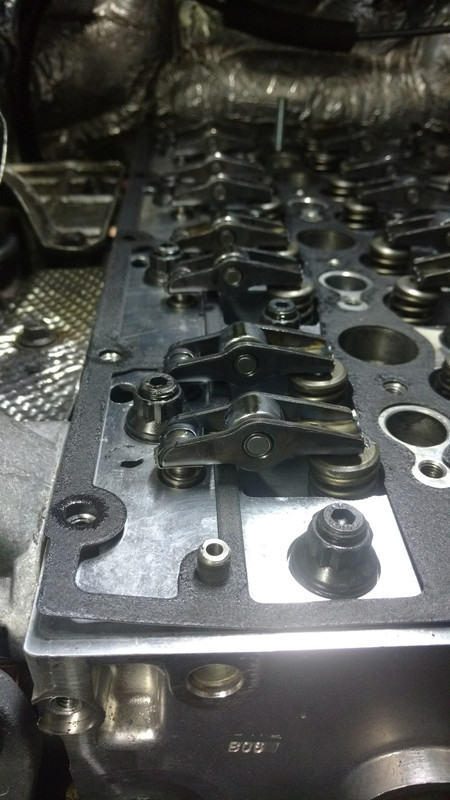

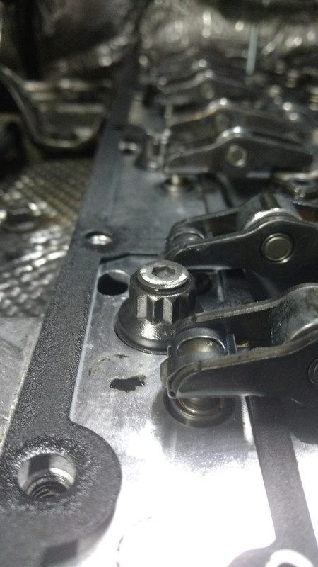

Well I have another issue that I'm at a loss to resolve. The ARP head studs I ordered from ID Parts were apparently too long and the four outside ones on the exhaust side hit the cam journal support so hard it left an impression saying "ARP 2000" in the intake/valve cover assembly seizing the exhaust cam. seems to turn fine now the I/V assembly is off but I'm concerned it could have cracked the cam journals. :banghead: :furious: See pics below

Did you mill the head?
Did you put the studs in all the way?
I've only done my own head with ARPs, New head, 2 hole gasket (that's what mine had) and didn't have this issue.

Yes I bottomed them out on stock heads. Still had 3-4 threads above the nut after torque. I never thought anything about it as this is the first I'd ever heard of the issue. Luckily I was able to get a hold of ID Parts and sent an email with the issue and was told to grind down the tops of the studs in question. Apparently they are still in process with ARP about getting a shorter stud. They told me that only the early intakes had this issue. Not so sure I would trust that assumption for anyone installing new studs. Would have been nice to have had a note in there saying to do the grinding prior...

Leave the nuts ON the stud when you grind them, you will have to remove the entire hex socket on top of the stud to enable them to seat deep enough. When installing, do not fully bottom the studs. When they bottom, turn them back 1/2 turn so that all the force on the threads will be even - if they are bottomed, the studs can be slightly side-loaded and this can weaken the studs or the block threads.
This is not an isolated issue, and your valve cover and cams will be fine. If you don't want to grind them, send me an email and we can talk about exchanging the studs - I have a limited supply of the shorter ones.
Already ground down. Yes I left the nuts on (this is not my first rodeo). I've been using ARP studs for 30 years. I always back them off at least a quarter turn then snug them up with an open end wrench and allen socket but once you start going through your torque sequence they will always turn often bottoming themselves out anyway (if you don't believe me try marking the tops of the studs prior). The point is to get an even pull on all the threads. Using a bottoming tap on the block and cleaning the hole prior to installation helps with this as well (which I did)
Thank you Geordi, by the way for ensuring this situation will not harm the valve cover. That was my big concern.
