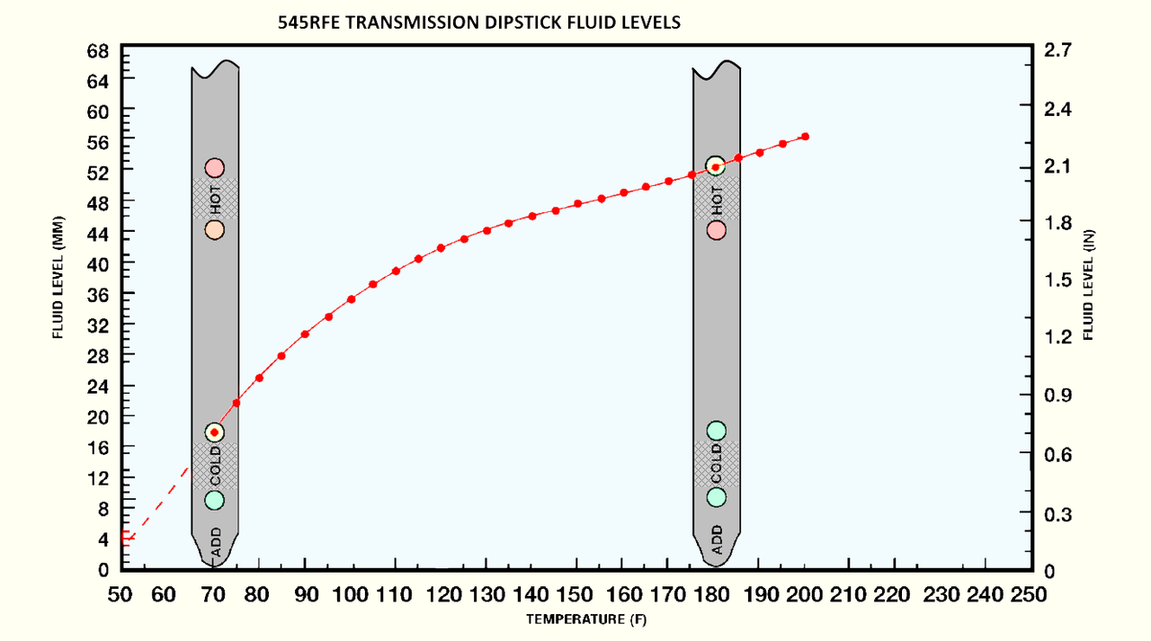

FYI:
The torque converter fills in both the P (PARK) and N (NEUTRAL) positions.
Place the selector lever in P (PARK) to be sure that the fluid level check is accurate.
The engine should be running at idle speed for at least one minute or greater, with the vehicle setting on level ground.
At normal operating fluid temperature (approximately 82 C. or 180 F.), the fluid level is correct if it is in the HOT region (cross-hatched area) on the oil level indicator (dip stick).
Note: The 545RFE transmission is a large transmission and owners have found from experience that it seems to function best if slightly overfilled with fluid.
Only use ATF+4 transmission fluid in this transmission!
Fluid level vs temperature

Thanks for these helpful posts. As an engineer (EE), I especially like the graph. I definitely have a leak, with fluid on the garage floor. Before driving it to my diesel mechanic today, I had to add two quarts of ATF+4, and it still just barely showed on the dipstick. I’ll let you know the diagnosis and the solution. My CRD is a 2005 with 125K miles, and otherwise runs great. If you’re in or near RI, Pascale Performance Diesel in Warwick is great!
Add some more ATF+4 until you get it up above the full mark; these transmissions function best when slightly "Overfilled".
Most run an extra quart in them. :wink:
I like WWDiesel's graphs and diagrams as well. Nobody paints a picture like WW can.
I wish I knew how to explain things using images like he can.... is it a software upgrade, WWDiesel? What can I do to post images like these?
