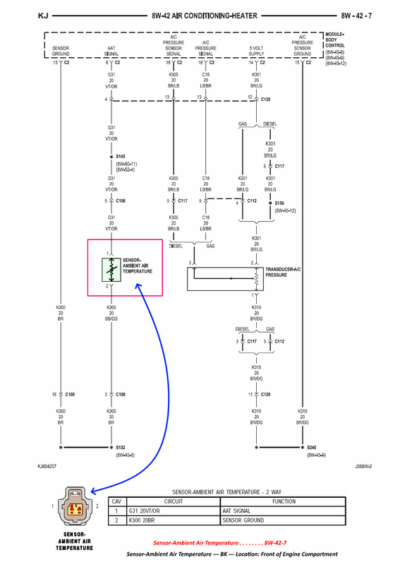

Just so there is no misunderstanding concerning the "Ambient Air Temperature Sensor".
The Ambient Air Temperature Sensor is located in the front of the engine compartment and is a separate sensor not related to the MAP sensor.
It is a two wire sensor and one of its wires (DB/DG) is attached to the same ground point that the Fuel Temperature Sensor uses. See page 8W-30-35 in the 2005 FSM.

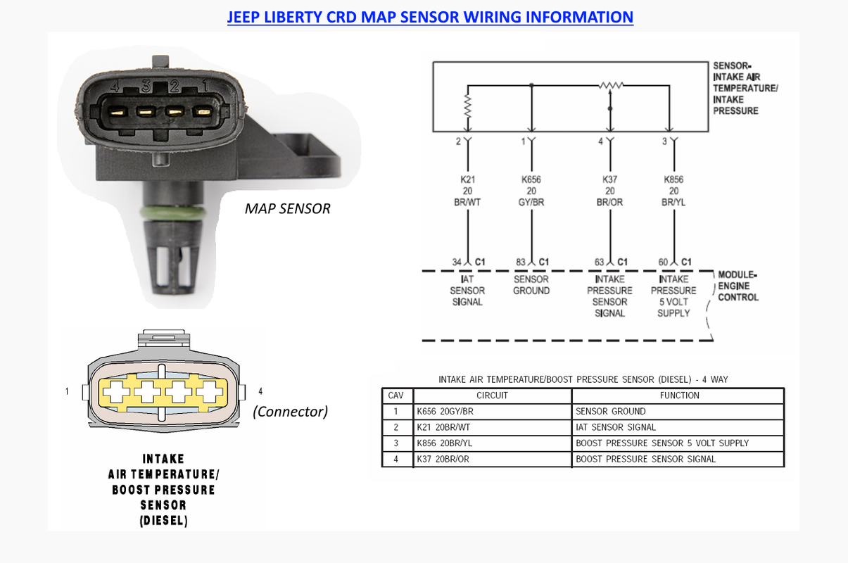

The MAP Sensor is a two fold combination intake manifold "pressure" and intake air "temperature" sensor. It senses both the air temperature and boost pressure inside the intake manifold AFTER the air has been pressurized by the turbocharger and cooled down after it has passed through the CAC (intercooler).
Unfortunately the 2005 FSM does not show the MAP sensor in any of its wiring diagrams, but the 2006 FSM does.
It is a four wire sensor with the following connections, See drawing:

@WWDiesel....Yes the 2005 FSM manual 8W-30-35 does show the Ambient Temperature Sensor but I can not find it in the 2006 FSM!
I remember having this discussion years ago on one of the Jeep KJ Forums and the consensus was that this Ambient Temp Sensor was in fact part of the Map Sensor.
I have not seen the engine bay of the 2006 CRD so cannot comment on where this sensor is actually located!
I do not think that this is too relevant here as this particular 2006 CRD seems to be throwing all sorts of codes all over the place!
WWDiesel wrote:
I agree, way too many codes all over the place to point in one direction to look for problem!
Got to be some electrical problems causing all these DTCs.
This could be a bad connection or shorting cable to the BCM or ECM which will be hard to find! :shock:
It is relevant to the point I did not want anyone milead and thinking the MAP Sensor provides Ambient Air Temperature on either 05 or 06 model vehicles, which it does not!
**The MAP Sensor has only two signal wires, one is intake (boost) pressure sensor signal (IAT), and the other is intake manifold pressure transducer signal.
The other two wires are a sensor ground and 5v intake pressure reference signal supply respectfully.
As to the 2006 model, I am sure you just overlooked it, it is shown on page 8W-42-7 in the 06 FSM. Under AC system which is crazy!

Yeah the Logics show a second black wire in the connector going all the way to the main ground but there are plenty mistakes in the Logics! :?

@WWDiesel.....thanks for that picture of the Ambient Temperature Sensor in the Logics! :wink:
I should have looked in the Airconditioning Section! :?
I must see if I can physically locate this sensor on my 2002 2.5 Export Diesel!

The ambient temp sensor was easy to find. Pop the grill off and it's right there at the top, in front of the radiator. I pulled it out and blew out the sockets. The pins had a little corrosion so I cleaned that off and stuffed it back in.
