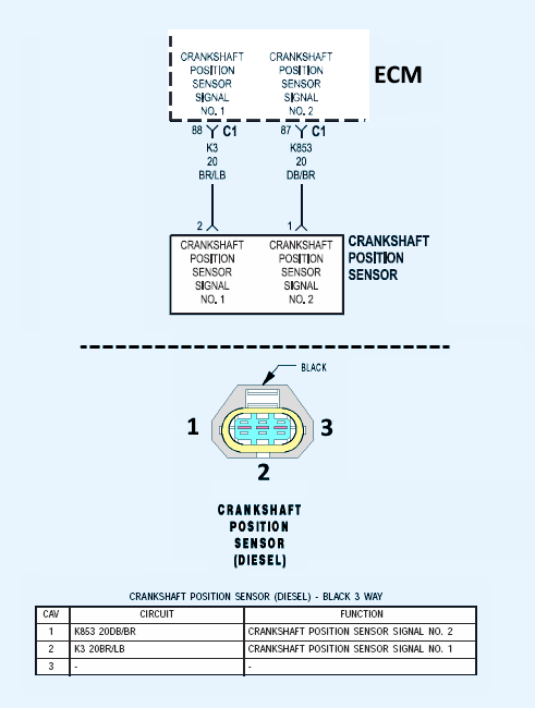

According to the FSM, the CPS is just a two wire magnetic pickup positioned close to a toothed reluctor wheel on the crankshaft.
The FSM does not show the voltage used by the FSM across the sensor.
Some sensors use 5v reference voltage provided by the ECM.
OPERATION
The crankshaft position sensor is a magnetic pickup type sensor that generates an A/C signal. The sensor contains
a permanent magnet and a coil of wire. The sensor generates an A/C signal each time a notch in the reluctor wheel
on the crankshaft passes across the permanent magnet. The ECM calculates engine speed based on the frequency
of the A/C signal.
If the PCM does not receive a crankshaft position sensor signal within 3 seconds of cranking the engine, it will shut down the fuel injection system.
