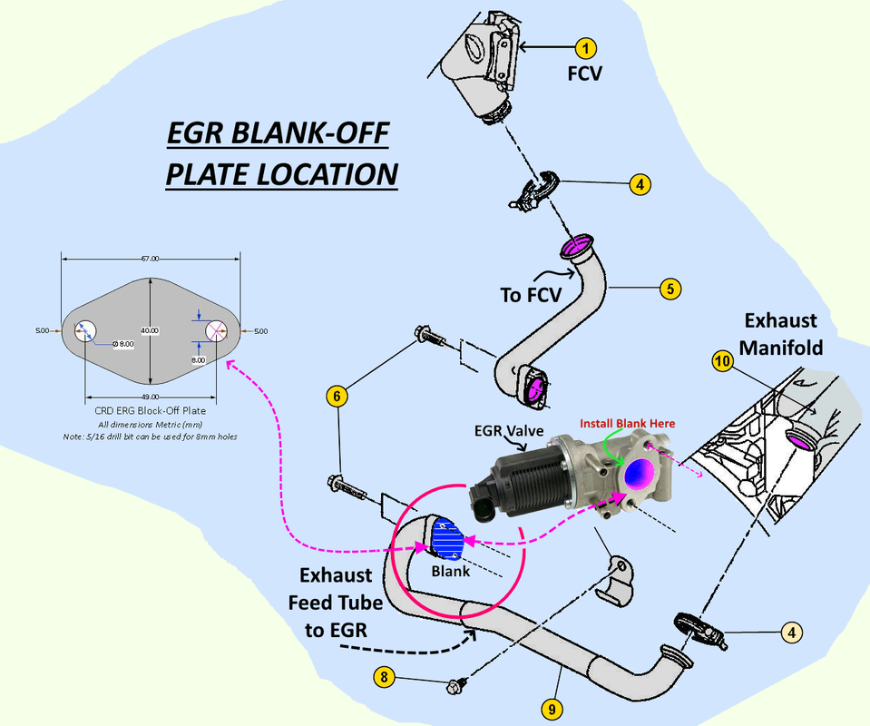

If you can, for sure delete the exhaust soot injection system (EGR). It will help make your engine last longer along with several other benefits like cleaner oil and better engine performance. :JEEPIN:
If you cannot do the full delete, at least install a block off plate between the exhaust soot feed line and the EGR valve as pictured below. You can make the block off plate out of any thin sheet metal even a lid from a soup or vegetable can.
All that is needed is a pair of tin snips and a 5/16" drill bit.
Then remove the butterfly plate out of the FCV (air flow control valve). It only has two small torx screws holding it to the shaft and is real easy to remove.

See picture, hopefully this will answer your questions.
The block off plate goes on the end of the exhaust feed tube from the exhaust manifold and the EGR valve at the EGR valve. Real easy to install, only two bolts.

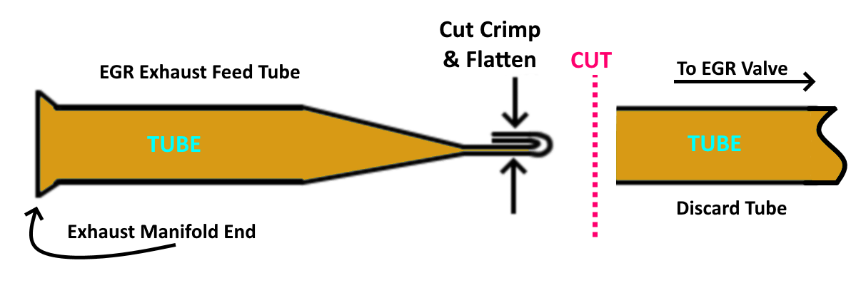

Some owners blank it off at the exhaust manifold end by removing the EGR exhaust feed tube, cutting it off a few inches from the clamp, then flatten the end of the tube out with a hammer and fold the end back over on itself and crimp it shut and then clamp the short piece of tube back on the exhaust manifold. This works too! See last drawing.
If you remove the FCV by installing one of the elbows, you can discard the tube that runs from the EGR valve to the FCV.

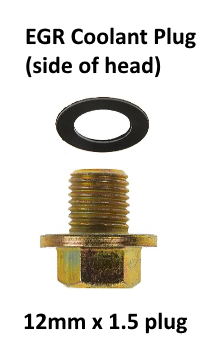

If you install the elbow in place of the FCV, and you have the blank in place, you can also totally remove the EGR valve, EGR cooler and all associated cooling hoses by plugging the coolant fitting in the center of the head and removing the "Y" where it feeds back into the water pump suction and replace the "Y" with a straight 5/8" hose connector.
FCV Removed, EGR Blank Installed, & Elbow Installed

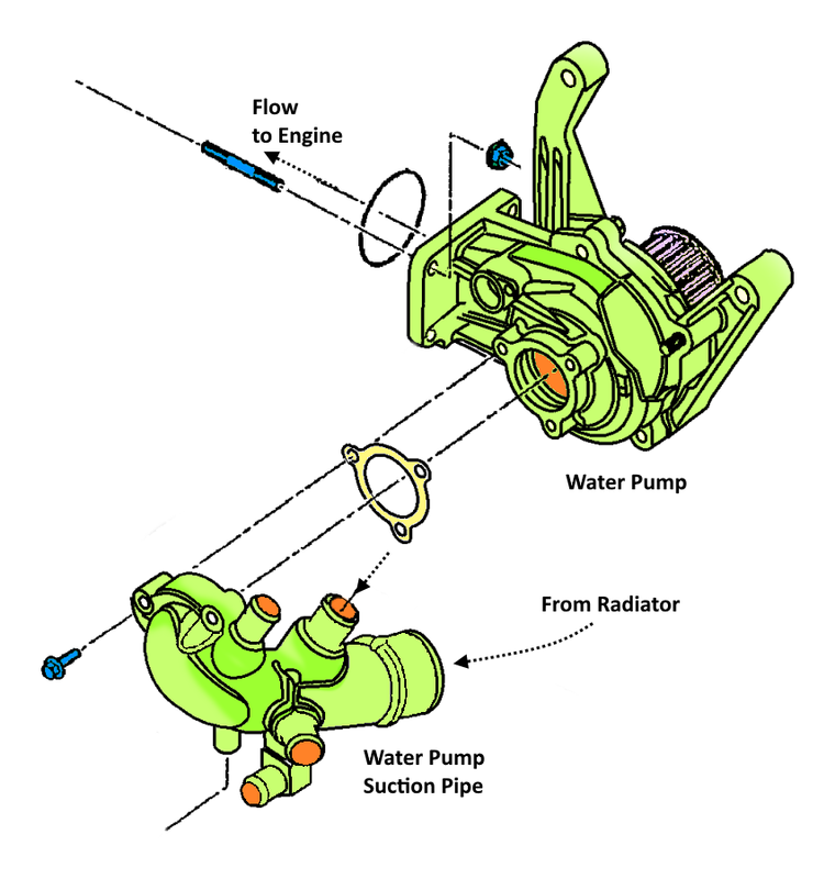

So next question - I'm now about to swap the water pump. The replacement is a GRAF pump and came with two rubber rings. I know where the big one goes, no problem, but I'm confused about this second, smaller but thicker one, it doesn't seem to have anywhere to go... I don't feel good about not using everything in the kit though so I wanted to double check. Any insight?Image

The smaller O ring goes between the rear water pump housing and where it bolts up to the engine block. Shown in picture below.
Most people only replace the front half of the water pump and that is where the big O ring goes.

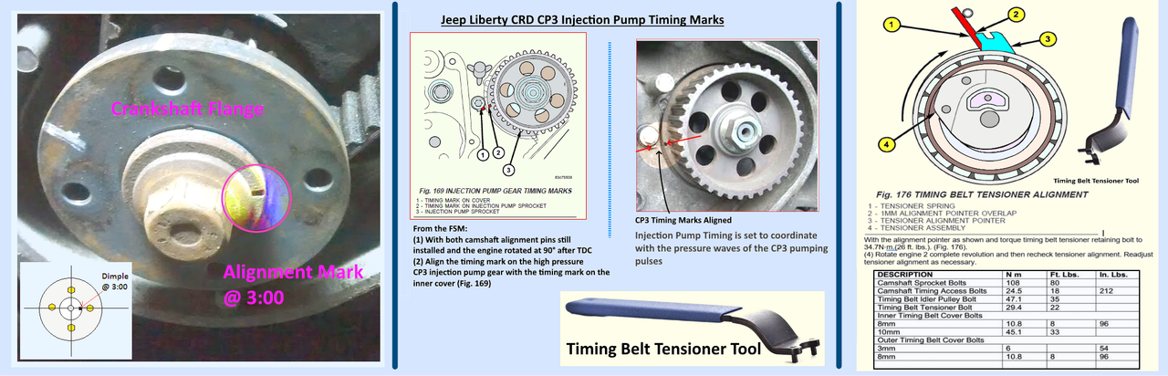

With the timing pins IN, tensioner bolt slightly loose, using the tensioner pulley tool, tension the timing belt to the proper tension and while holding it in the correct position for the proper tension, tighten the tensioner bolt to the correct torque. Then remove all timing pins and rotate the engine over by hand a couple of revolutions until the timing pins will go in again and recheck the belt tensioner that is still has the proper tension setting on it. If it is not still in the correct tension position, re-tension it and repeat steps above.

Hey there! I'm doing the EGR delete now, and am wondering about the thickness of the block-off plate. If I remove the EGR valve and cooler, do I need to use a thicker piece of metal, or would the lid to a can or a jar still work?
Sent from my SM-G973F using Tapatalk
 Post subject: Re: Changing water pump - what else to do?
PostPosted: Fri Oct 07, 2022 9:48 am
Posts: 7375
A thicker piece of metal would probably be best if you are totally removing the EGR valve.
But keep in mind, there is not a lot of exhaust pressure in the feed line against the block off plate.
or you could back up and blank it off where it comes off the exhaust manifold at the V clamp.
A simple way to do this is to remove the exhaust feed tube to the EGR valve, cut it off a few inches from the V clamp mounting location.
Then using a hammer, place the cut off end on a vice or piece of metal and flatten the cut off end shut.
next, fold the flattened end over on to itself with some pliers and crimp it shut with the hammer.
Reinstall to exhaust manifold, and your done. :D :D
