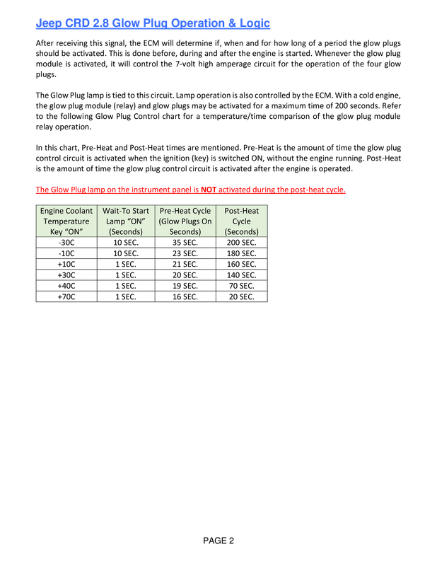

There is NOT a simple or easy answer to explain the logic and how the glow plugs operate.
The Glow Plug Module is controlled and operated by the ECM that uses pulse width modulation to pulse the glow plugs current levels as needed based several input signals to the ECM.
Lots of variables that affect their operation and duty cycles. (heating time)
It has been determined that the GP heating times chart in the FSM may be incorrect on actual times.

Thanks a lot for your input and graphics you shared WWDiesel. Plug operation & logic is quite useful.
So bottom line, would you say that if the glow plugs have been replaced, and the Jeep still struggles or can't start in cold weather, the next step would be to look at the module / relay? And because it's so complex, I would need to swap it out to see if it addresses the issues ?
Other thing I'm thinking about that could be faulty is the coolant temp sensor that then tells the ECM what to do. There isn't another temp sensor linked to the GP module and ECM is there?

See my original post earlier in this threat that lists all the sensors that the ECM uses to control the GP module.
The ECM is looking at several inputs to determine how long and how much current flow is required.
So if any of the sensors that the ECM uses for GP module operation are not providing an accurate reading/signal, it could greatly impact GP heating cycles and thus cranking performance. :cry:
If you could find someone with a scope, they could see how well the GP module is performing by graphing the time and voltage duty cycles being outputted to the GPs.
or
Replace the GP module with a known good module or a new one. But this still would not tell you if the problem is an issue with the control coming from the ECM and all the ancillary inputs it uses for determining GP operation. :banghead:
