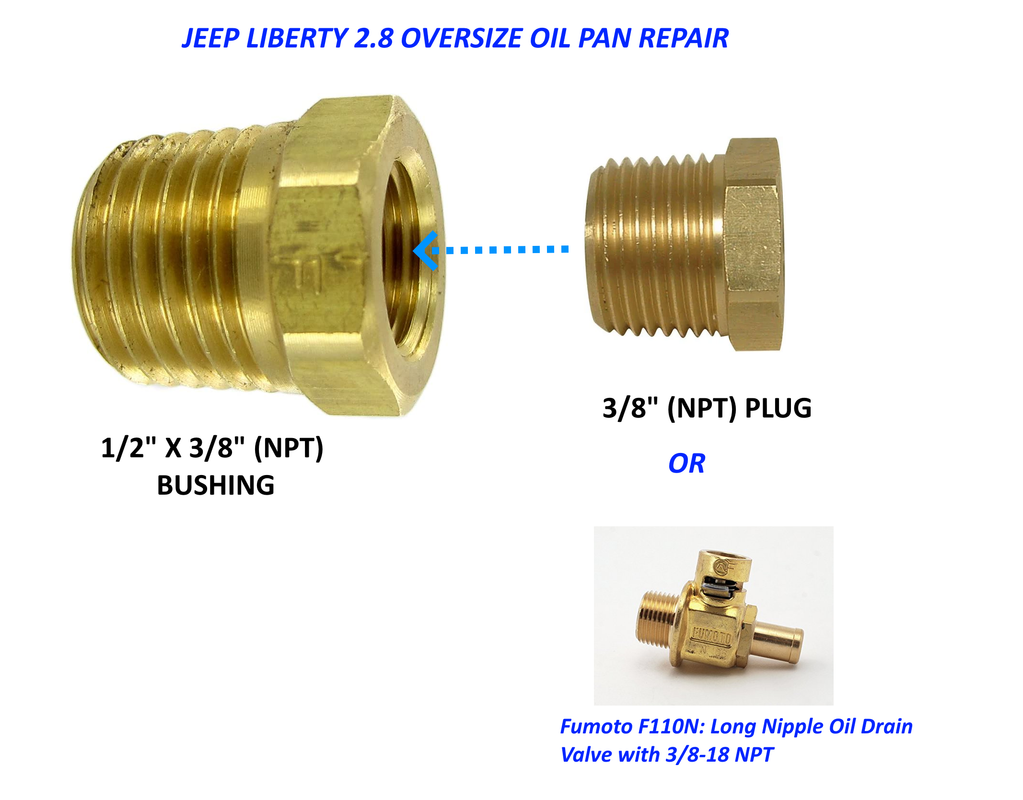

Worst case oversize, you can tap it out to 1/2" NPT, insert a 1/2/3/8 pipe reducer bushing with JB Weld on the outer threads, and then use a 3/8 NPT pipe plug for your drain plug or install a Fumoto F110. I have actually done this on one engine several years ago and it is still working just fine. Beats the heck out of having to replace the oil pan!
