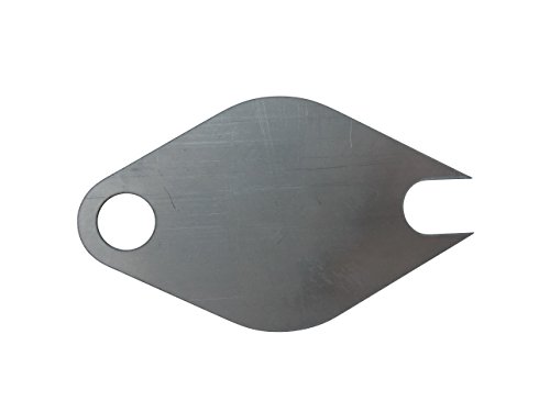

Does anyone remember what the mod is where you block off a return line down by the side of the engine block, near the rear , oil pan (maybe?) with a little hand cut steel "shim" block off plate with two bolt holes in it?

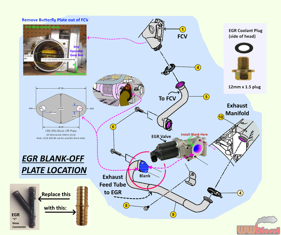

You mean this one: Image

Yes . But mine was blocked off on the rear side of the engine, by the oil pan .
Not the front like you photo shows.
Block off plate fits both locations apparently

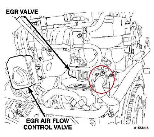

The blockoff location circled in red IS the rear of the engine (drivers side).
This is the best place. A simple piece of tin can (canned fruit etc) fits well. Mine is a small disk. Once in place it cant be seen.
I have also blocked off the inlet connection on the inlet elbow. Again, using a piece of tin can.
Its only sealed on the inlet side so its not a sealed cavity.
