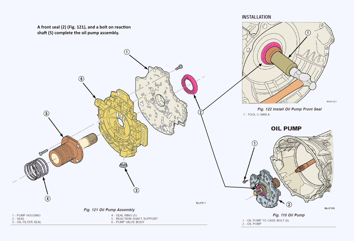

I'm going to pull the engine out of Silver, put it into Green, and then make the updates to Green. While the engine is out of Green, I'm going to replace the torque converter, transmission pump, and will install the Transgo kit. I ordered the TC from Florida Torque Converter, and I plan on ordering the Transgo kit and transmission pump asap. Now for the question, if possible, I plan on buying a rebuilt pump, with Sonnax updates for the 45RFE/545RFE, 99-07. I see where others have also replaced the pump, so does anyone remember if the seal is on the front or back of the pump?

Maybe this will help? See drawing below.
The FSM (factory service manual) can be viewed or downloaded online at:> https://www.colorado4wheel.com/manuals/Jeep/KJ/
The FSM covers the transmission repair and front pump & seal replacement.

I figured you would be able to help. It's been a minute, but I've seen the service manual link before and forgot about it.
Thanks for the help.
