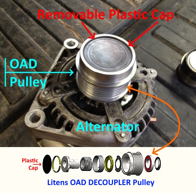

Does your alternator have the OAD pulley? (overrunning alternator drive pulley)

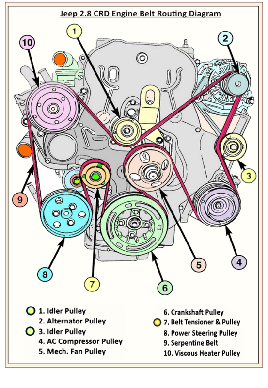

Have you replaced the belt tensioner mechanism? See diagram, item No. 7
All three alternators appear to have this pulley.
moroza wrote:
We've also replaced the ... tensioner assembly
