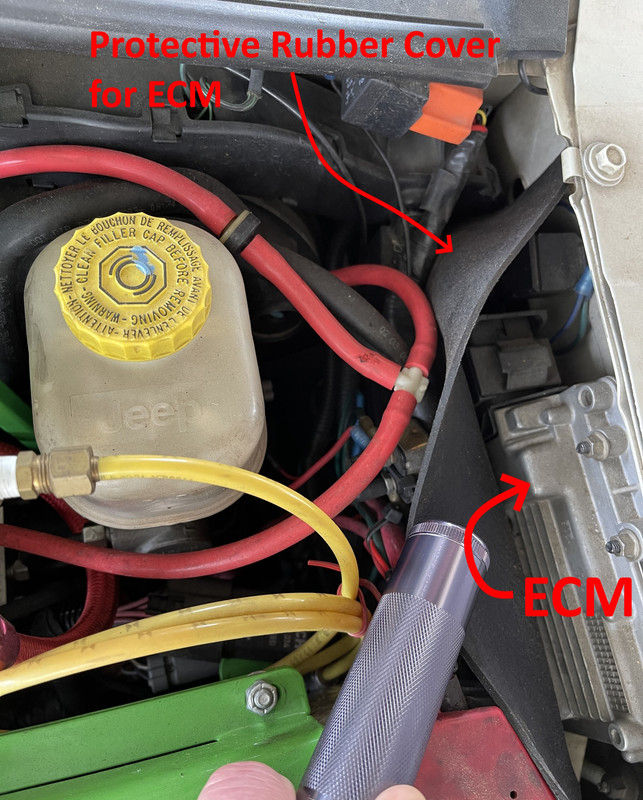

Wish you had told us about shorting out the ECM to the positive battery terminal up front, advice would have been quite different. :shock: :banghead:
You are very lucky indeed! Count your blessings; there have been a couple of others on this forum that have done the same thing and it fried the ECM and they had to replace it. This gets very expensive with purchasing an ECM and getting it all programed with the correct VIN number, mileage, security code, etc... $$$$
As a precaution to this, I made a cover out of some rubber insulation tape and covered my ECM to protect it from anything accidently coming in contact with it.
